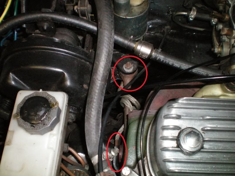

We're looking down at the clutch end of the block, I've circled the two ends of the engine steady. Between you can see the braided strap - my replacement was a lil long so I've wrapped the excess around the steady. The strap attaches at both ends using the bolts holding the engine steady which is itself just a solid bar (a replacement is possibly an adjustable).
My problem was at the upper circle - the strap attaches to the bolt that goes thru a bracket and the steady vertically. The nut was on the bottom, out of sight and out of mind. The bolt probably would've stayed in place even if the nut was gone completely! The grounding strap was flopping around on the bolt but with the nut just loose; when found it was probably backed off a good 1/4 inch from tight.. Sometimes vibration left the strap with a lil connectivity - other times no. Sometimes I turned the key and the car fired right up - it has always been an easy start - sometimes it did nothing because w/out this path you can send juice to the starter but nuthin is gonna happen - you have an open circuit. But everything else in the car was normal, only the block was missing the ground. I turned the bolt over so the nut is now on the top and if loose I'll see it.
