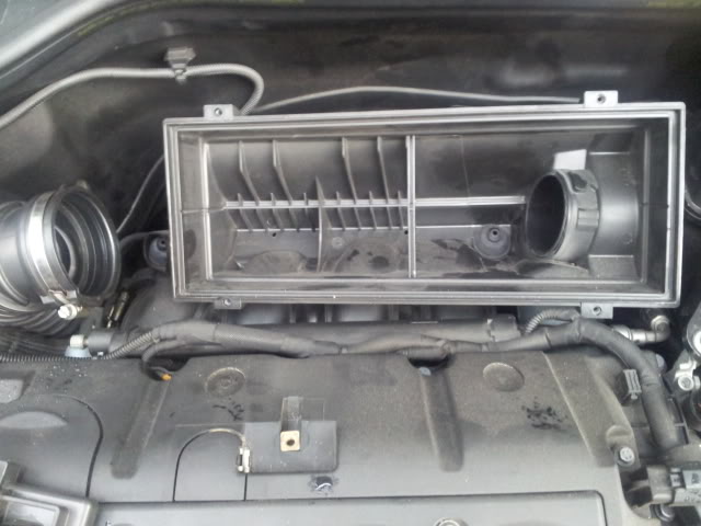

Just got my DDMworks intake and plan to install it on my own. Apparently, I did not expect that the installation require the removal of the entire stock intake. (Previously was on K&N and it only require the removal of the top intake cover.)
While trying to remove the base of the stock intake, there are 2 nut which is not the usual screw/ nut we see securing the intake. Wasn't able to remove it as I do not seem to have any tools to remove them. Does anyone have any idea what kind of screw or nuts are those and how to remove them?

Anyone manage to install it own Mini Cooper Non S LCI model? I am starting to wonder if this is compatible as the installation guide seem to be different on the stock intake that I am having.

Hi, do you mind posting some pics of the installation? From the installation guide, it seem like it only require the removal of the top stock intake. However, it seem that I need to remove the entire stock intake in order to install the DDM intake.

Any idea how to remove this bolt?

I got mine installed and love it!!
The housing just pulls off of those screws. Then when you attach the new box the new supplied screws just screw into those!
