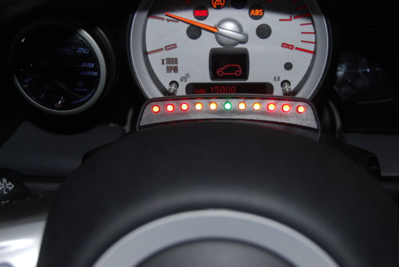

JCW Shift light is installed....
It was an easy mod since it is factory everything was done pretty well. It took me about an hour but, if I had to do it again I could do it in 30 minutes. You dont really need any tools for this.
1. Removing the factory cover is a little pain, I used a tiny screw driver to pop the clip points and presto...it was off.
2. The JCW shift light comes with a new cover, its as ease as running and securing the wiring then snapping the new part in place.
3. There are only (3) wires you tap into place. I have a PDF from BMW if you need a copy.
4. Test to make sure it lights up and then tuck everything in place.
There is an on/off button on the back of the light pod. The Gree light is a little bright at night. I used a tiny piece of Limo tint and I will see tonight if that tones the center green light down a bit.
You only see the other lights when you get over about 5K.....dont hold me to that but I will tell you the lights start coming on when you well into the power band and should be starting to think about shifting.
The light is more of a day to day novelty however, I can really see if you autocross it could be an effective tool....
I would like to see a gear shift indicator for the autocross days..anyone know if there is a company that makes one?

So when do you shift? When everything is lit up?
If you look at picture #2..it is at full light up..it is a scale, so in that picture it shows your at red line. Ultimatly you want to shift before you hit red line for the best performace...or the power curve starts to go way down. I say if your autocrossing you would start to get ready to shift at the end of the yellow or rigt when you hot the red light. You will hit red line pretty quick when you see red and are at full pedel..

Thanks for the pics. I have been considering this myself and I wanted to know how much this unit would block out the lower information display. Still haven't made up my mind yet but your pics were just the information I was looking for.
It does block a little depending on how you have your wheel height set. If you are sitting low it will block the info screen a little..But there is a fix, you can bring up the tach a little with some washers. I find the top of the tach to be blocked the way I have everything set anyway.

Even better Red Bull. I had no idea it would be so easy to adjust the tach height. Now I have even more to think about. Thanks alot!
