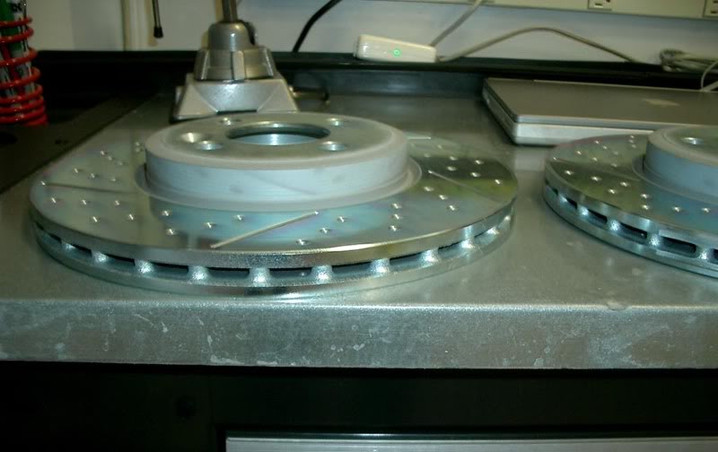

Correct... I switched my 08 MCS front rotors to the JCW sport rotors (drilled and slotted) and it is a direct fit. Of course like the OEM rotors they rust so I have them out right now being zinc plated (meaning the slots, drilled holes and cooling veins will retain zinc and not rust but of course the brake pad to rotor contact area will have no zinc plating and still rust such as after washing... but that rubs away quickly obviously).
EDIT: They came back from the plater:

I picked them up from the dealership where I took delivery of the MINI... cost was $218 for both... surprising this is less than many of the Internet sales
