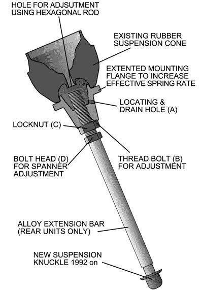

Here is how they work, A friend in North Florida sent me this it wasfound at the Mini Spares web site.
ADJUSTMENT
The threaded bolt (B) in the Hilo unit has a total travel of 33.5mm. This theoretically allows 100mm of adjustment on the front suspension and 167mm on the rear although this will be limited by other suspension and bodywork considerations. This permits the car to be raised or lowered as required.
Before carring out any adjustment the lock nuts (C) must first be released. Adjustment of the front units is then acheived by use of a spanner on Bolt Head (D) or passing a shorter hexgonal rod through the existing hole in the bulkhead crossmember (it may prove easier to first remove the bonnet) and rotating the rod with a suitable ring spanner. Great care should be taken to ensure the car is supported on the front subframe before removing the locating bolts and cover plate or single central locating bolt. Failure to do this could result in the subframe location being disturbed. The rear units arer simply adjusted by the same method or passing a longer hexagonal rod through the hole already drilled in the rear apron. Both front and rear units are easily adjusted however by turning the bolt heads (D) with a spanner. If the cones start to rotate when being adjusted this may be preveneted by inserting a rod or screwdriver in the drain hole (A).
VERY IMPORTANT
The Hilo unit should only be adjusted once the car has been jacked up. Do not try to force the bolt round once it has reached the end of its travel in eather direction. If the Hilos have been fitted for some time or used in very dirty conditions it is a good idea to clean and lubricate the exposed thread before adjusting .
If using very low ride heights the rubber cone may become displaced when the vehicle is jacked up. In addition, shorter shock absorbers should be fitted to prevent any possibility of them "bottoming out".
When ride heights are adjusted to extremes it is advisable to reset the steering geometry and wheel alignment.

ADJUSTMENT
VERY IMPORTANT
if you gonna use 13" you will need to cut the front fenders out to fit....there is a templet out there in internetland somewhere
ADJUSTMENT
VERY IMPORTANT

ADJUSTMENT
VERY IMPORTANT
