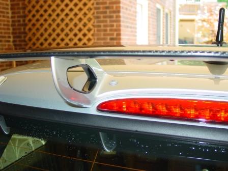

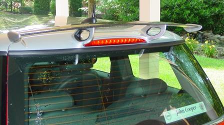

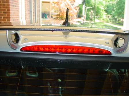

Old Jun 11, 2006 | 10:55 AM
770 KOF's Avatar
770 KOF
Joined: Oct 2004
Posts: 171
JCW Spolier Pictures
Okay here are the pictures I promised. I think the JCW spolier fits the look of the car pefectly. If I'm not mistaken the cars in the JCW Challenge Cup in England all seem to use the JCW spoiler (look in the JCW catalog) so it's functional and not bling.
