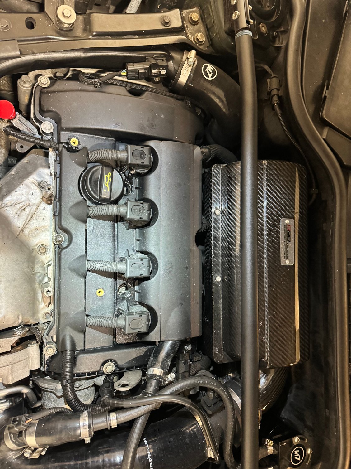

Hi everyone, I’m new to the forum. I just recently purchase a 2010 JCW, is my second mini and is a project that I’m trying to bring back to life. The mini is in good condition just need a new paint job and some small repairs. Right now I have to replace the valve cover that is leaking. It looks like oil is coming from the PCV valve enclosure. I was planning to buy the one from ECS. Any recommendations?
Thank you for adding me to the forum!
As you can see there’s some oil residue around the coil plugs. The previous owner installed a new valve cover back in October 2023. I was reading that the aftermarket covers tend to fail. Any suggestions? Thank you!!

Nice intake and nice Rare MINI!
I have an aftermarket plastic Bremmen Parts version and its fine so far. Most of the time people spill oil when doing an oil change, then it looks like a leak (clean it up first). The Genuine MINI ones don't last too long either, many heat cycles and they can leak their also. Make sure if you do get a new one to install according to the install sequence.
https://www.northamericanmotoring.co...acement-2.html

  1. Thanks for the info. How do you guys feel about the aluminum ones. I heard that they are better.
Old Feb 12, 2024 | 09:46 AM
Posts: 36,758
Likes: 2,548
The ones we have are fine, we have people running them. Other brands i have seen issues. Most of the time its installed wrong or they did not tighten down the oil cap or attach the hose right. We also carry lifetime replacements for the original owner. https://www.ecstuning.com/LifetimeReplacement/
