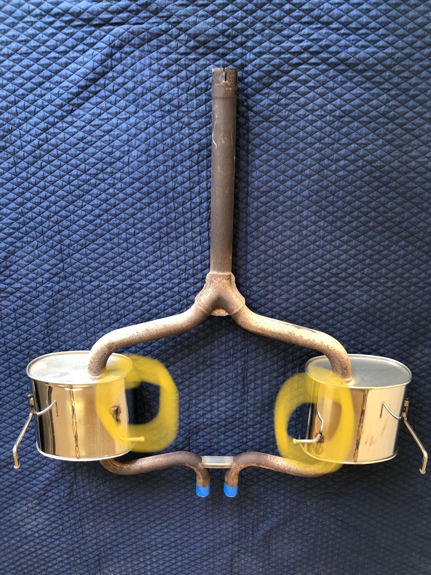

MY research indicates:
18-10-0-395-483 pre-facelift 2002-2004 prior to 1/2004 production date with inside muffler hangers pointed to rear
18-10-0-301-874 after 1/2004 production date with inside muffler hangers pointed sideways
18-20-7-545-128 2005+ with bend and flat area near rear "Y" area to accommodate clearance for extra R52 convertible chassis bracing

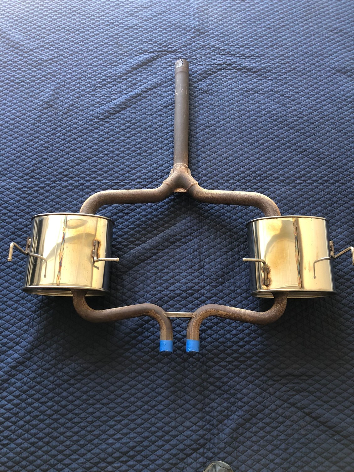

To my knowledge the pre 1/2004 JCW exhaust is NOT available new. However, I’ve been told you can utilize the other two versions by modifying the inside
hangers (bending).
I actually have a used one for sale if interested.
ie,. Bend inside muffler hangers to rear !

yep you can do that to work.
