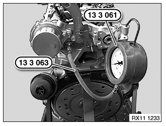

Here is the official spec for N14 oil pressure:
This measurement should be taken at the pressure switch location, on the head, next to the vacuum pump. Remove the switch, and install your pressure gauge.
While your idle pressure is within spec, your pressure at 3000 rpm would give me concern. Since you replaced the oil pump, maybe you got one with too much clearance, or the oil control solenoid isn't working correctly.
