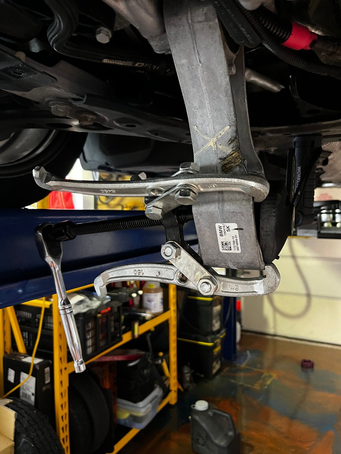

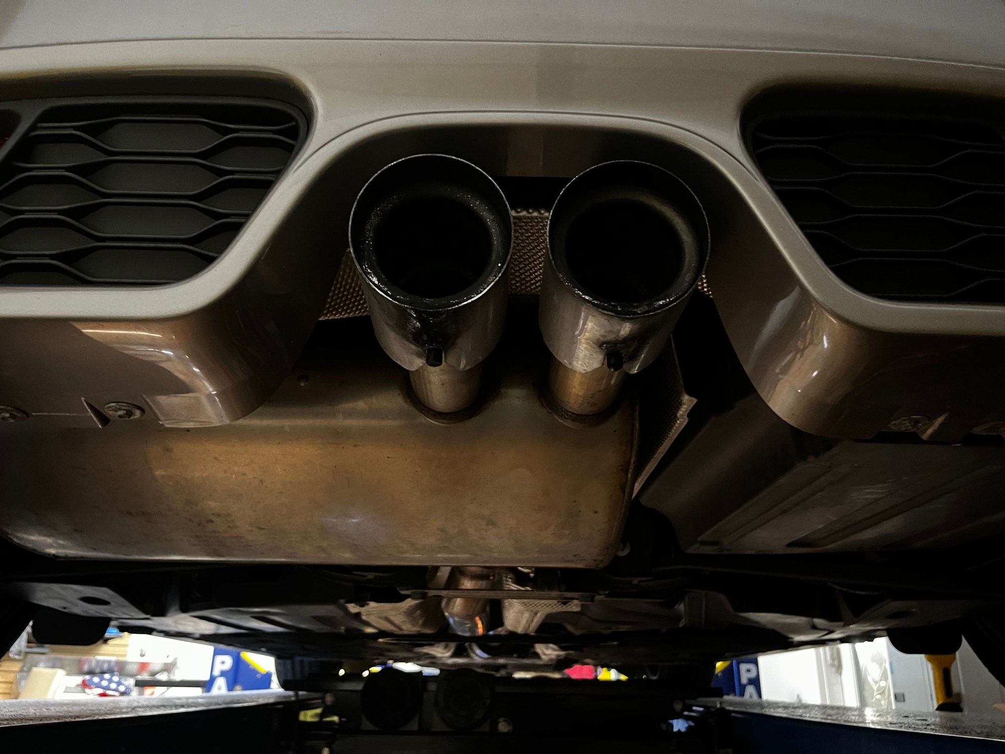

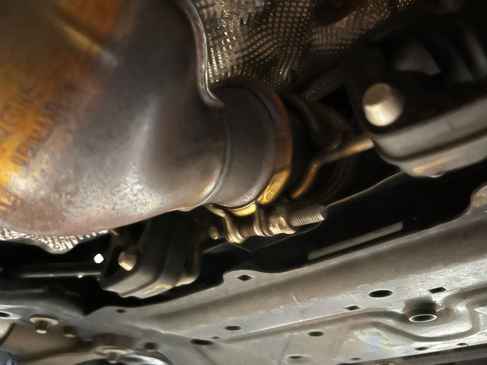

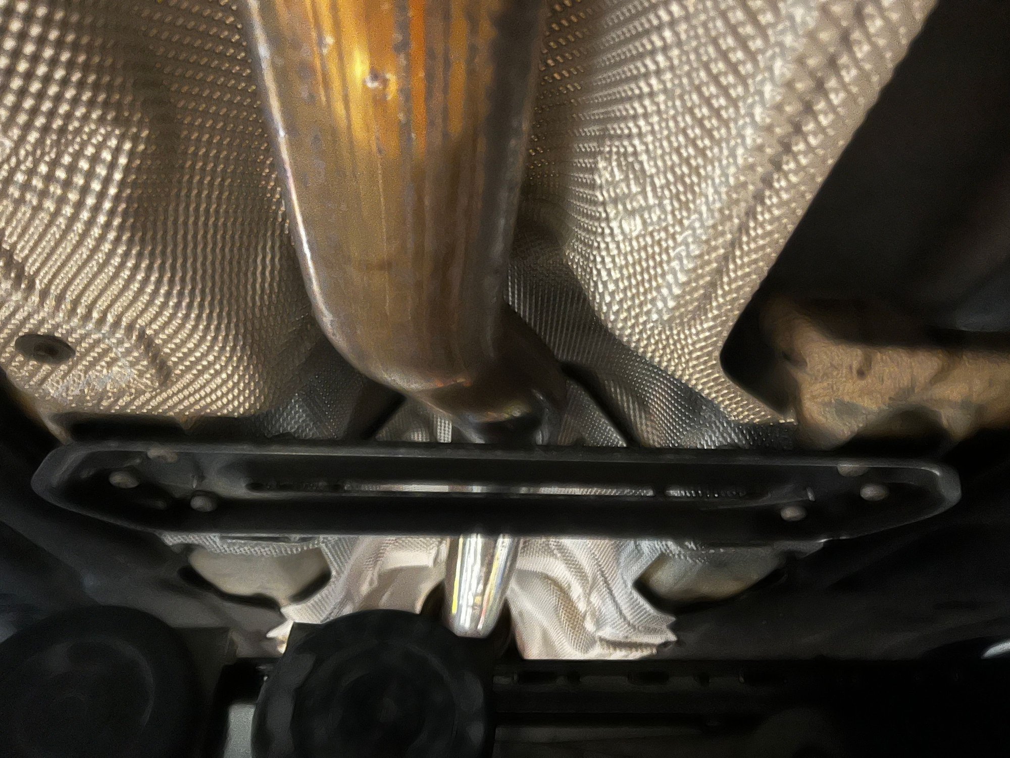

OK brief update and pics below…The JCW Pro exhaust install was pretty simple, thought I now have a 7 year old JCW exhaust on the side of the house. Used the Vibrant exhaust clamp (longer, stronger, better), installed the Big Pair from Cravenspeed. Mechanical part easy and quick. Wiring requires you run from back to front - not hard and used some threads from here but time consuming. No way would I have been able to be successful in connecting to the fuse box without the threads from here - definitely pull out the blue “tray” and used the pics for reference to find the right plug-in spots for wires and fuses. When done, controller paired up immediately and sounds great - though have only run on the lift.
Also pulled the old Dinan Elite and sent in to Dinan. They have a great video that is helps a lot and honestly not too hard to get to the DME. Sent in DME and old Dinan Elite and they flashed the DME with a 93 octane Stage 1 Tune and sent back the same day they received it (Sent out Friday, received DME back Wednesday). Great to work with Dinan, able to talk with someone - and they did the flash for “free” since I was original purchaser of the Dinan Elite. Really curious to see how this tune works - finished re-installing and putting engine bay back in order today.
Also replaced my 2016 brake lines with NM Stainless lines - dirty job even with a lift, and the space to work with is quite tight. Definitely recompress the tension spring clip to ensure tight tension on hard line nut screw. Motive Pressure bleeder makes flushing super simple just make sure you have the European adapter.

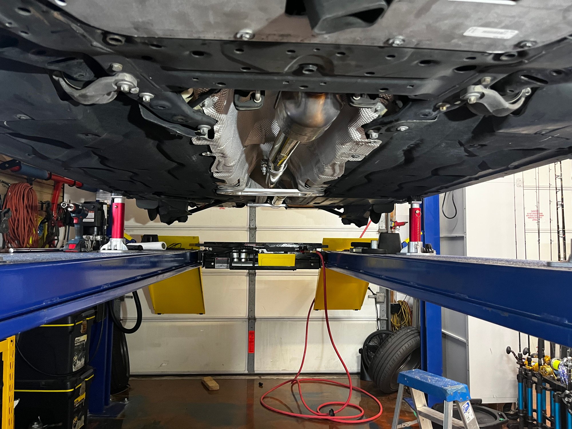

Waiting on my brake pads and sensors - FedEx has been pretty poor with pushing ship dates. Once have those will be driving and bedding in new pads (EBC Red). I also installed the the Powerflex black motor bushing (pulled out the small inserts) as well as the Rennline skid plate. Living in south Florida there is always stuff in the road and realized the starter motor, wiring, and oil pan are really at risk with a standard mini- much less one slightly lowered (NM Alpha springs). Rennline skid plate is a pretty beefy piece of aluminum - though do recommend you buy some of the Grommets BMW/Mini use to attach the felt skid plate (you use these attachment points for the Rennline also) - 7 year old plastic is pretty brittle.

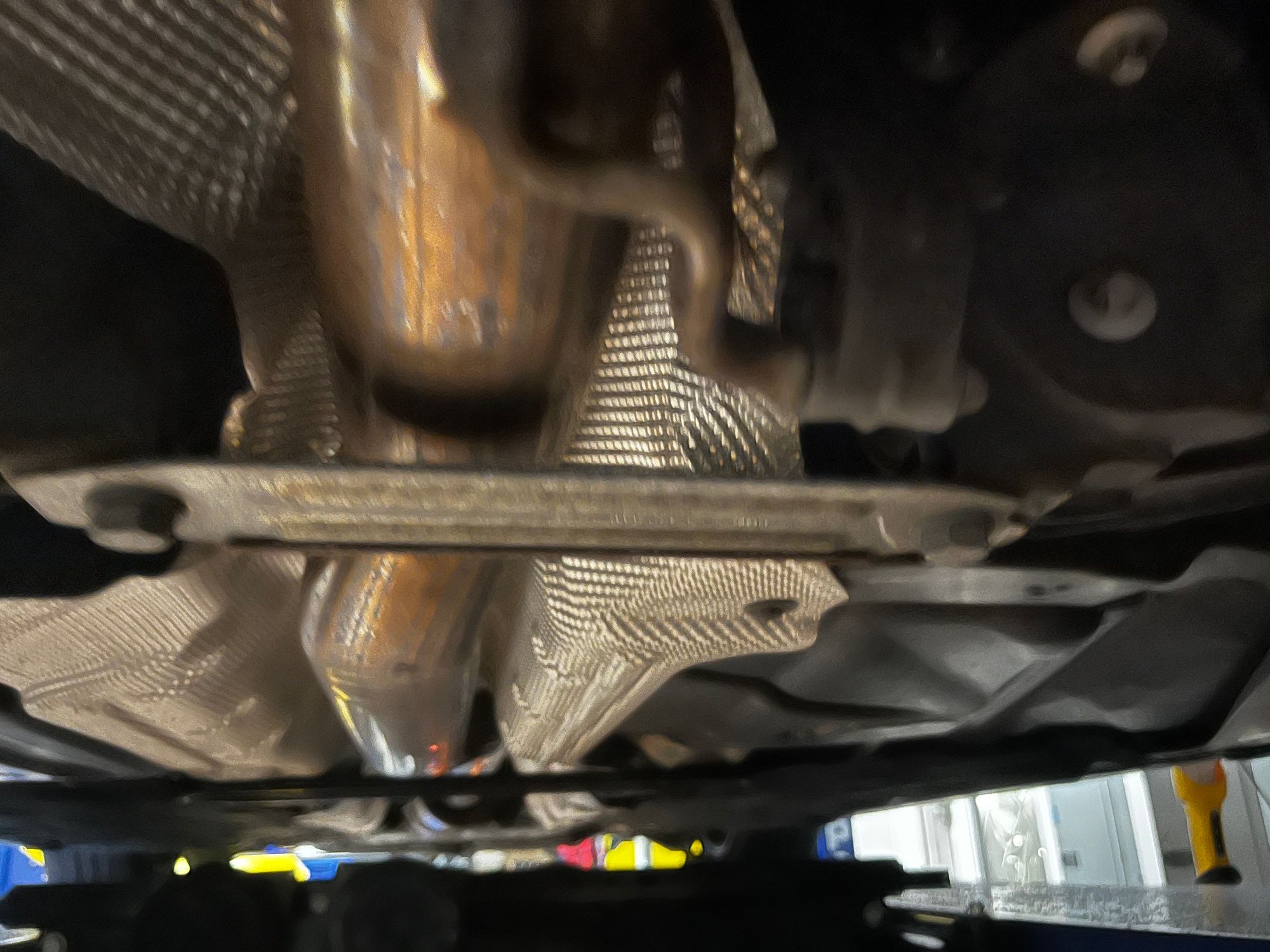

Rennline Skidplate
Back of Skiplate and start of JCW Pro Exhaust

JCW Pro Valve Closed

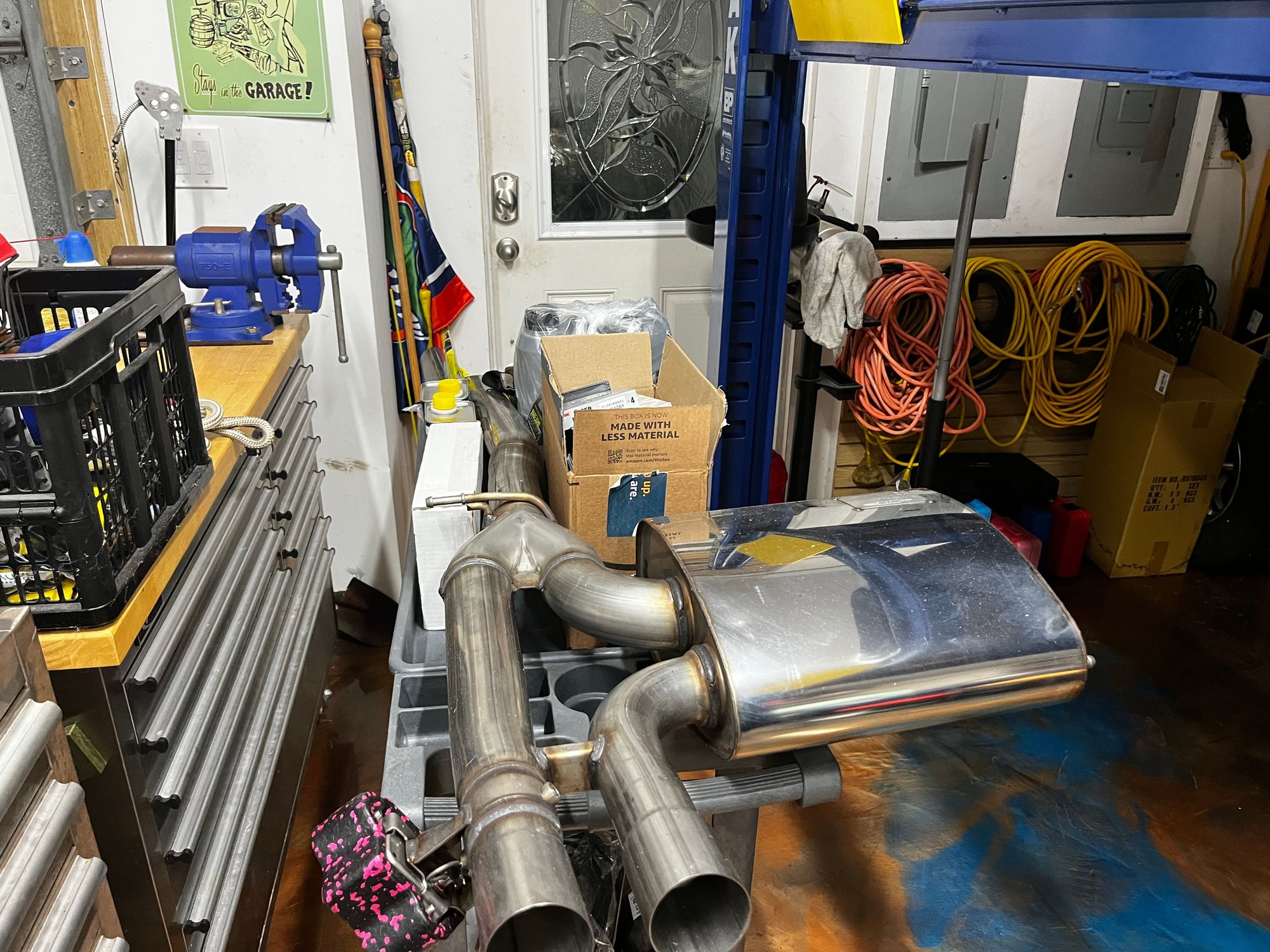

Old exhaust next to JCW Pro
Lower motor mount - pressing out the old rubber bushing with 3 prong gear puller - works great
