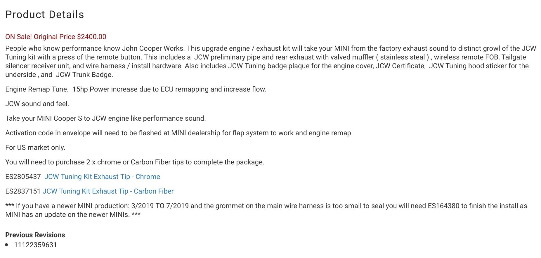

Hope this information helps, below is the JCW Pro Exhaust that fits our 2020/21 vehicles. Enjoy, Jose
