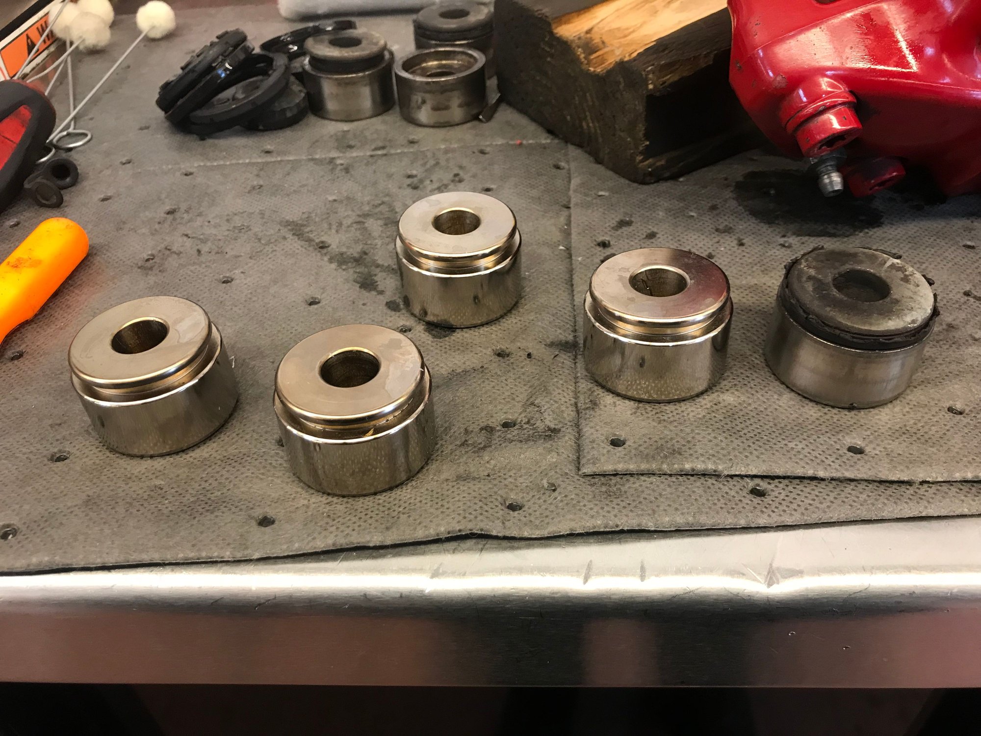

So I went ahead and ordered the rebuild kit from Bigg Red, the pistons seem to fit very well, I only got a chance to rebuild one caliper so far, but hopefully next week I can finish it up and install them on the car

Wow, that looks really good! Thanks for posting. Can you share the ebay seller? I can't find it for some reason.

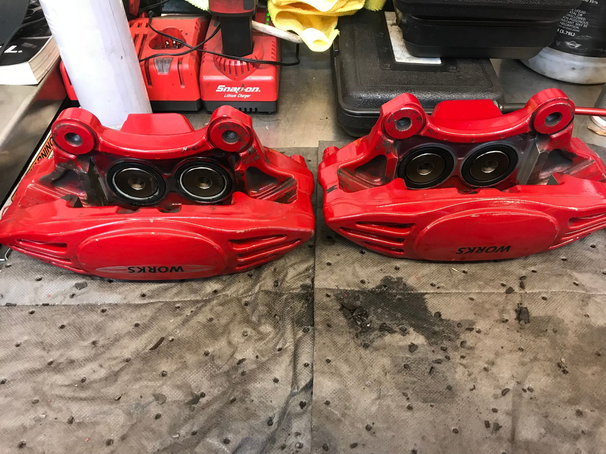

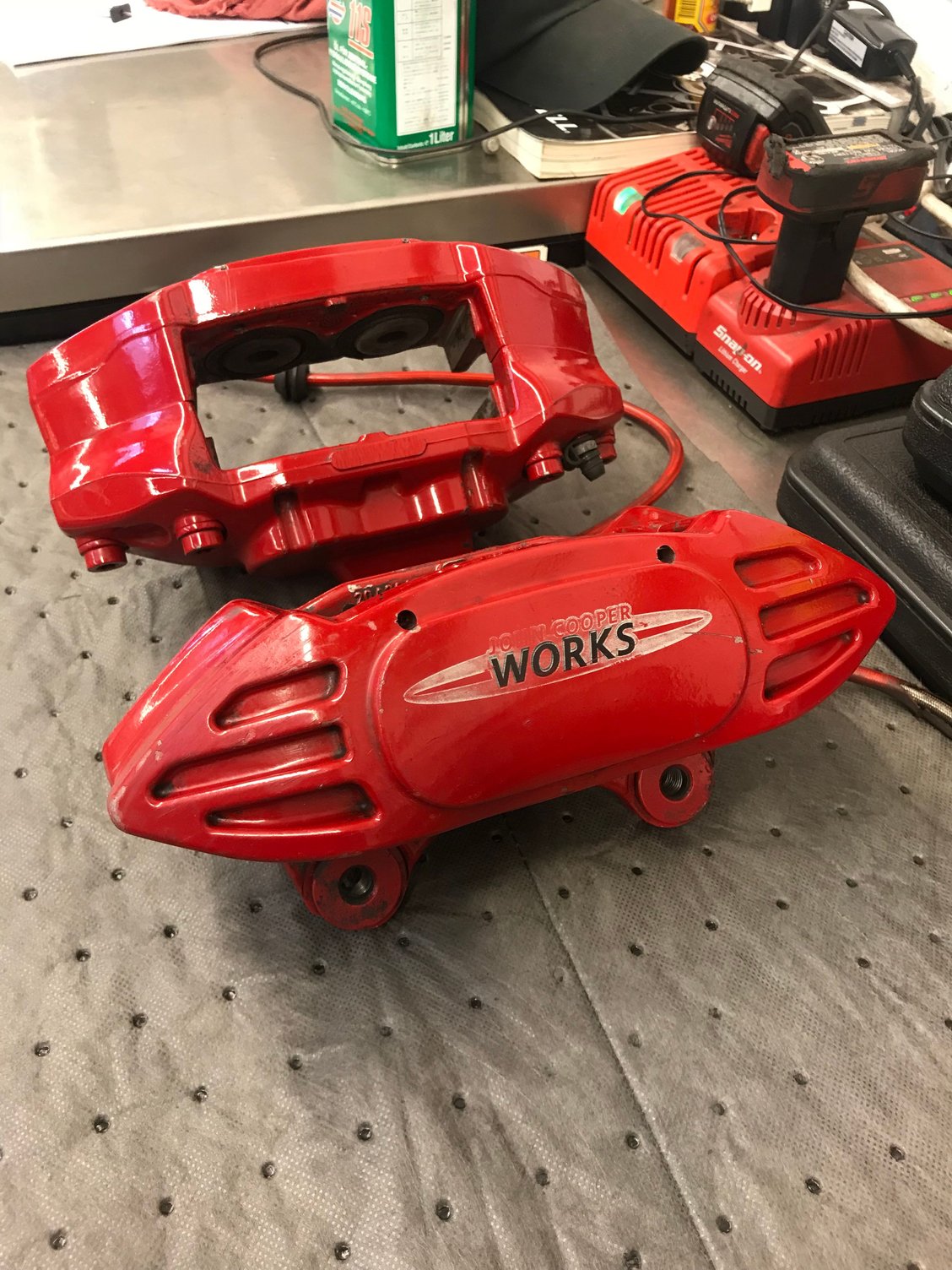

So I fiannly got a chance to get the other caliper done, very happy wth the results, hopefully I’ll have a chance to install them by the end of the weekend. I will updated after they are installed after a couple drives.

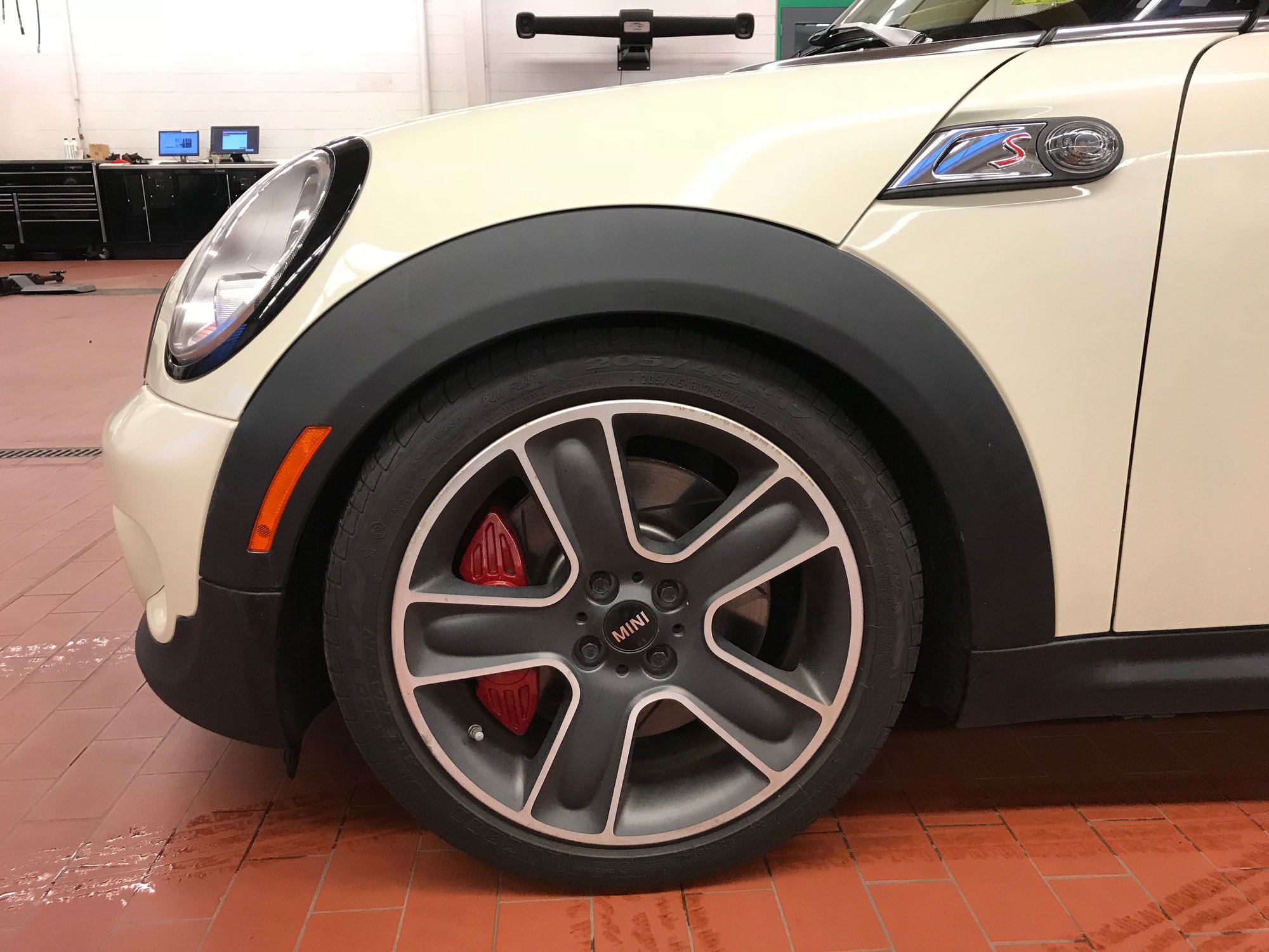

Hey guys, so after about a week of driving with the rebuilt calipers I took the pads out yesterday to inspect the pistons. Everything seems to be holding up and the brakes feel great! I will be attending the dragon this year so I’ll be doing some hard braking and can report on the calipers after that.
