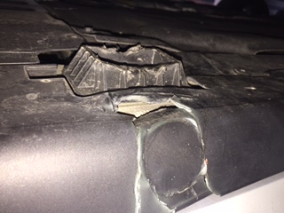

Ok folks I need some help. Tried searching the ole interweb and could not find what I need.
I need those weird square jack pods/brackets/mounts whatever you call them. I also need the drivers side black trim that runs the whole length of the car. I think that part number is 51777352151 but would like to verify. Had a boo-boo and rushed a tire change and my floor jack slipped.
Also are there any adapters so you can use a regular floor jack without messing up those square things.
Pics attached.
Lastly is this a job I can complete with basic mechanical skills?

The black trim for F56 with the JCW body package it 51777352151 Driver side . Couple of clips and the bottom clips. Which most of the time are included with the past MINI trims.
http://www.realoem.com/bmw/enUS/show...11#51777352151
Jack Pads
51717169981 clip into the bottom , you can see what they insert like on the back side.
https://www.northamericanmotoring.co...-tool-kit.html
