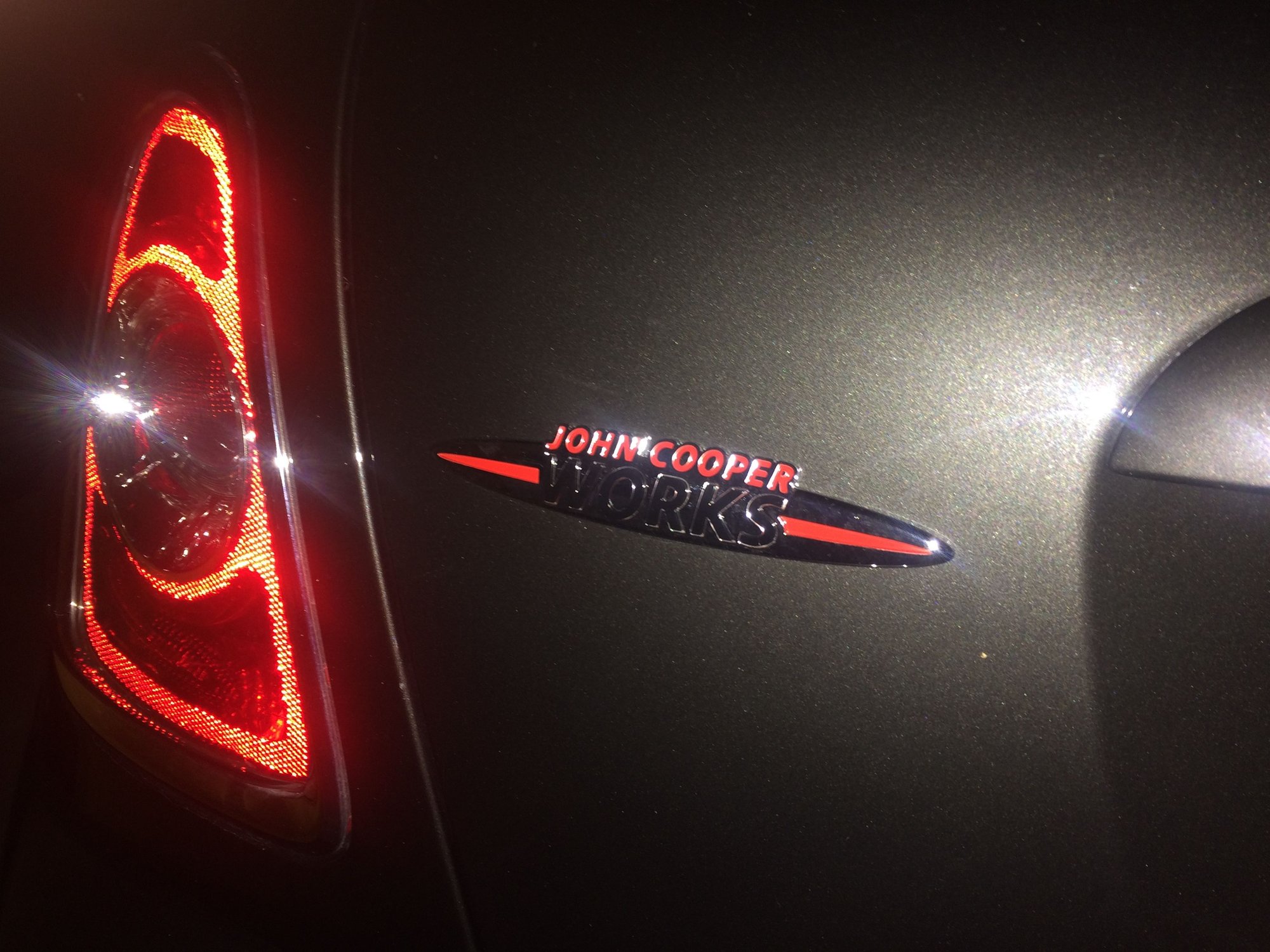

Nice, do you have pics of the MINI w/ tuning kit?
