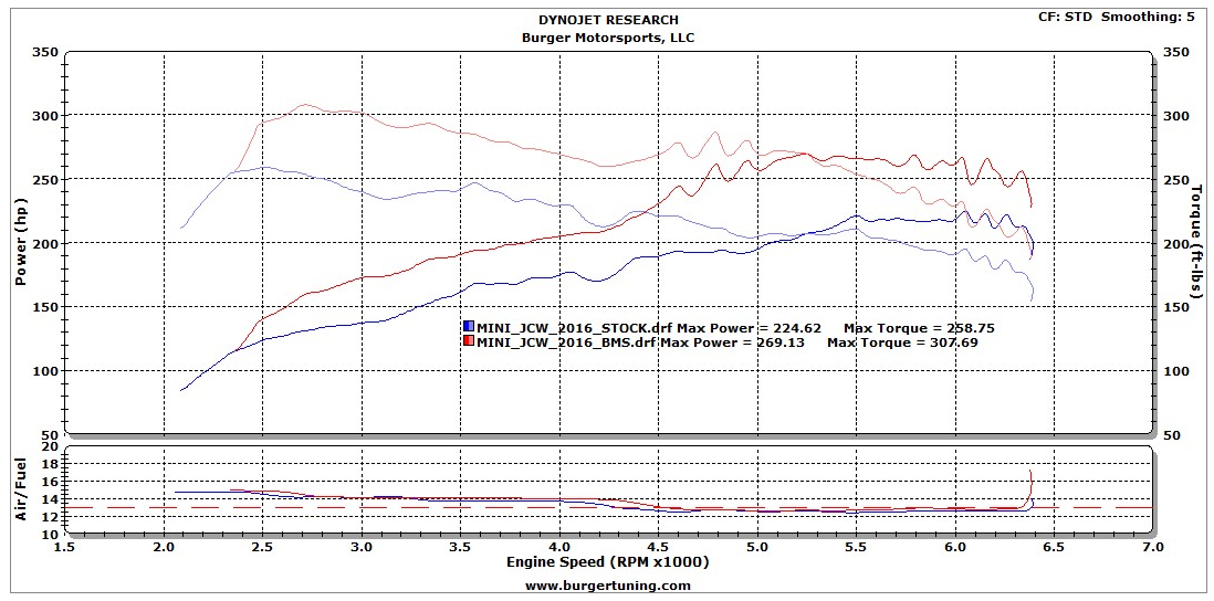

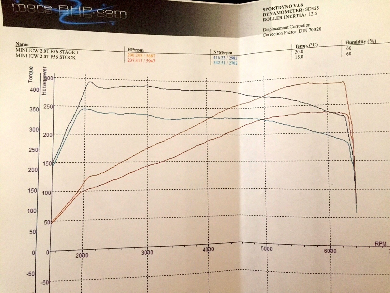

There are several dyno graphs out there. Burger, More-BHP, and mct from Sunshine MINI's all have posted believable dynos.
In my attachments here, Stock vs. Burger on a mix of ethanol with a +5 PSI piggyback. More-BHP stock vs. their Stage 1 ECU tune, and More-BHP stock vs. the TMC piggyback. In all cases, the JCW is dynoing very well. Obviously, the brand and operation of any chassis dyno can give you numbers that look good. None of these graphs have data logs to back up their measurements.
