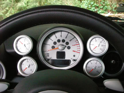

I have a Marshall oil temperature gauge, it tracks the water temperature pretty closely, within five degrees.

I'm considering the P3 gauge to read coolant and oil but curious about your oil temp gauge. Where is the sender located please?
Old Jun 27, 2015 | 07:03 AM
DneprDave's Avatar
DneprDave
Joined: May 2010
Posts: 3,260
Likes: 87
From: Pacific NW
It is on the same adaptor as the oil pressure sender. On the head near the vacuum pump.
The Craven Speed adapter has multiple sensor ports I just positioned it in such a way that I could get the oil pressure, oil temperature and the OEM oil pressure sender on it at the same time. This is on an N14 engine, when they redesigned the N18 head they moved the oil pressure sender to the oil filter.

That is one smart move.
