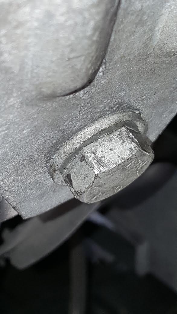

I just tried installing these. Had no problem with the bigger one but the bolts on the smaller one wouldn't budge. Looks like they are welded on. I'm I the only one who is/had this problem?
I contacted Cravenspeed, so waiting on a reply.

Soak the bolt heads overnight with Kroil or another penetrating oil. Use a 6 point socket with a breaker bar or slip a pipe over the end of your ratchet to give you more leverage. They're not welded other than probably corrosion. If you live in an area that gets snow and ice and drive your Mini during the winter then chances are you'll have some corrosion. In the first picture the galvanized bracket looks corroded to me.
Thanks I'll try it out.
