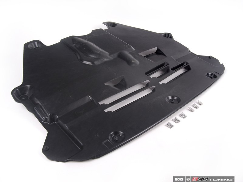

Hello,
The pan just has to be dropped for an oil change, it very light in weight. Much like the JCW GP 2 Belly pan kit.
Also there are little plastic washers on the back of the speed screws so when you undo they , they say with the tray, and don't fall to the ground.
We include all the additional hardware ( which does not come with just the pan ) so all you do is hold it in the middle and with a quick turn 1/2 of the phillips head screw , it comes out. You can see the speed screw on the corners of the pan.
Countryman / Paceman JCW Belly Pan Kit for the ALL4 and the JCW Countryman for the US , which was not a stock item. 51759809304KT 51759809304
http://www.ecstuning.com/Search/SiteSearch/51759809304KT/
Not hard for oil change.
Thanks and hope that helps.

Hello bmrguy03,
Just saw your post. Comes with 6 additional clips needed for the install. When you take off the side splash guard ( passenger side ) you will those clips there, and then add the 6 in the other blank ( missing locations ), line up the pan and turn the pre-installed speed screws at all 9 locations.
We built the kit with hardware to be in all-in-one install as we did all the work to make sure it works for you . PM me if you need anything else.
