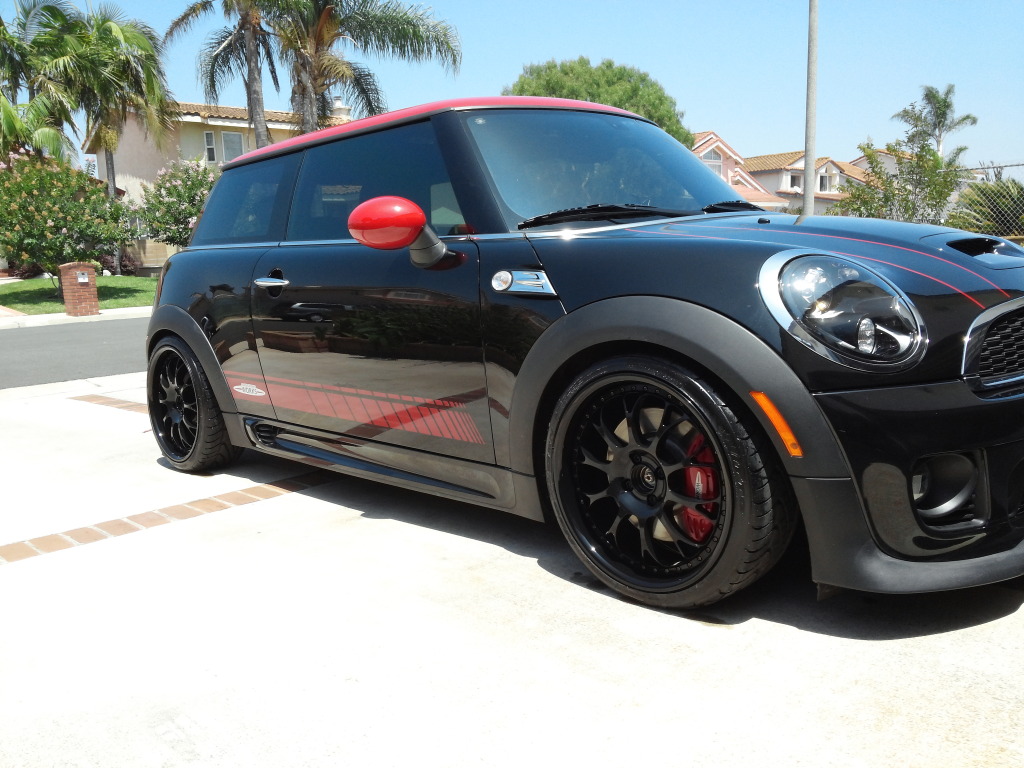

OP..i have 2012 jcw as well. KW v1 installed on my car. I don't track or plan to. I want to look nice and use a daily driving. the most important thing is that i don't plan to muck with the compression or rebound so that is why v1 is good for me. So far i am happy with it. Much better than stock in term of response to the road.

i spent decent time researching before putting the kw v1. Most recommend to get rear control arm(i end up with hsport). While you install the coilover, mind as well install the rear sway bar (my ireland engineering).
Notice my front, that is almost the highest setting i can go with that. The rear is somewhere in the middle. With that setting, my rear alignment was way out of whack...maybe that is why people recommend to get the rear control arm. During the first week of the coil over install, i had adjusted the height and drove over 250 miles and did the alignment.
I was in r2afanatics's car, man that ohlins coilover is so nice. His car is much lower than mine and it was very confortable, feel like factory without the run flat crap.
My suggestion is if you have the money and able to afford it, get the ohlins. If you want the bang for it's buck, either ST or KW v1. Since you live in nasty weather ( i can say that because southern california ) u should get the kw v1. Also not sure about hr street performance coil over, they little bit cheaper than KW v1. Lastly, if you go for cheaper coil over, then you can use that fund for something like RSB, rear control arm, and maybe evolve tune or something.
The thing about some member, i.e. r2afantics, they really into handling and suspension. He track his car therefore, he wants best. I am not dissing ohlins, kw v2 or v3 or other high end coil over, i am just implying that unless you going to spend a lot of time at the track, then yeah justification is there.
I specifically looking for either ST or KW V1 because i want to adjust the height only and not other stuff, i.e. compression and rebound. Adjusting those can be a nightmare and have to worry alignment. Murphy law apply to human being that if you give us control, we are going to FU...hehehehe
