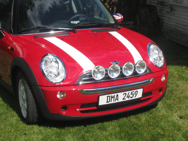

Here is my homemade light bar.
Attached Thumbnails Palo Uber Light Bar (Installation Hell)-img_2883.jpg   Palo Uber Light Bar (Installation Hell)-img_2888.jpg   Palo Uber Light Bar (Installation Hell)-lights-side.jpg
