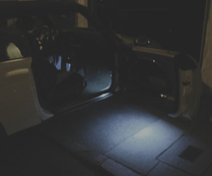

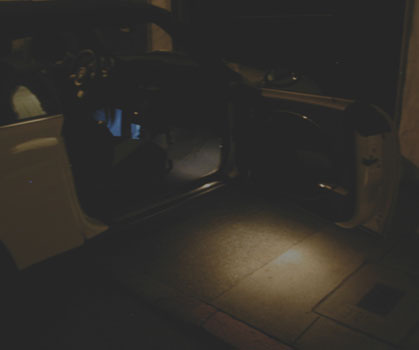

Here's the best I could manage so far. The images captured by the camera looked rather different from real life and I tried to adjust them closer to what I saw. Note that in these pictures I had covered the dome light to better show the difference of the bulbs.
Here are the footwell and puddle lights with stock 194 bulbs. Over on the drivers side footwell the white LED was already installed and you can see its bluish glow.
Here the footwell and puddle 194 bulbs were replaced with white 194 LEDs from v-leds. You can see in the puddle light how this LED throws a brighter and wider light. Pretty significant difference from just changing a single 194 bulb.
Attached Thumbnails Light that boot! (LED trunk light MOD)-stock.jpg   Light that boot! (LED trunk light MOD)-vleds.jpg

I've been watching this thread for a while and this latest variation has got my attention. Really great work and ideas here by all! Kudos ImagoX or is that Dr. LED?

Originally Posted by Red Scooter
Are the ones you used called the FLANK version of the 194s? Also, does 194 refer to the replacement socket size or ???
Would one of these work for the dome light?
194 is the bulb type, that uses a particular socket and has a certain size. They are also called W5W, T10, 501, mini wedge and other designations but 194 seems to be the most common name in the US. This is what a standard incandescent one looks like:
An LED version of a 194 usually has the LED mounted on the end like these:
However the socket is sideways in the footwell and puddle lights so they would shine light in the wrong direction. The one I used from v-leds was their "flank" version (a curious name they chose), which has an LED element pointing to the side and makes it perfect for the footwell and puddle lights. The flank version would also work well in the cabrio boot light fixture (but the hardtop boot uses a different bulb).
The dome light in a hardtop uses a festoon type bulb instead of 194. The cabrio does use a 194 in the dome light but the socket is vertical so you would use the regular style LED bulb instead of the flank version.
