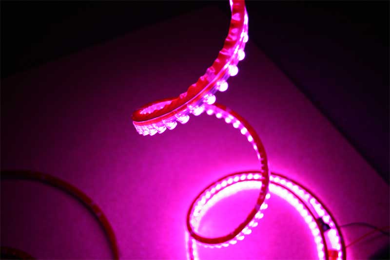

Oh darn... I have an exam tomorrow. Why am I always on NAM when I should be studying? Haha.
Anyways, so I was reading this thread and amazed at all the work put in by ImagoX and YD and thought "of course the LED's won't come in pink and it's not like I'm going to change my colour scheme, so I guess I'm screwed."
Uh oh for my credit card bill/studying time: they come in pink.
Expect me to explore this MUCH FURTHER this weekend when the exam is done. I love that picture with the white boot lights and then the rest of the cabin is red. I'd love to do that but the rest of the cabin be pink !!
Old Jan 5, 2007 | 07:20 AM
  #190
ImagoX's Avatar
ImagoX
Posts: 5,692
They SO come in pink!
