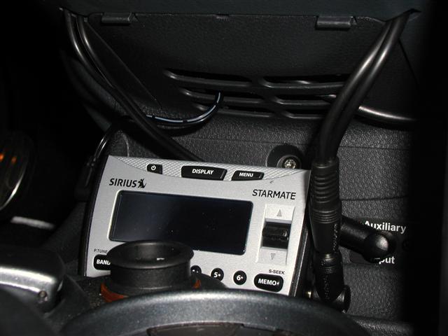

One thing that I did when using the GLI was to place it inside the opening just above the center console tray. All the holes thru the panel already exist, so it's easy to route the wires down to whatever device you are using. Of course, this works best if your aux input is installed in the center console area.

I used the Radio Shack GLI. It's about $17 and it's in the shape of a small cylinder with about 6 feet of wire attached to it. You do need to buy an extra RCA to 1/8 stereo plug adapter as was mentioned by rkw. It also helps a lot to buy a couple of 90 degree male/female connectors. By the time you are done, you have 1 wire going from the AUX input into the center console, and another wire coming down. Plug your device into the wire coming down and you are good to go.
