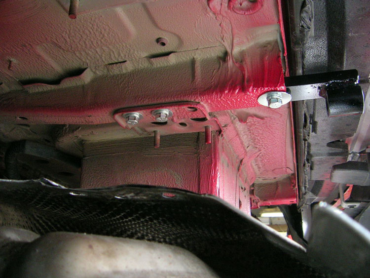

Hammer,
If you lift the tail end up real high (I used a lift), drop the exhaust hanger under the middle of the car, drop the exhaust hangers on each side of the battery box... the exhaust system will hang down enough for you to remove the heat sheilds. Then you can get at the battery box if you need to drill into it.
The pictures show the shields and exhaust hanging down. The underside picture shows the battery box in the background, exhaust mounting studs a little forward of that, and the channel in the foreground (with part of my home-brew hitch installed in the channel).
Hope that helps somehow.
Cheers,
Paul
Attached Thumbnails Trailer Hitch attachment-dscn1538.jpg   Trailer Hitch attachment-dscn1537.jpg

Paul,
Thanks for the pics - it shows what I feared. The way this hitch mounts, I need to drill a hole in the box beam between the rail (box beam) and the battery box. How in the heck am I supposed to do it? Others have mounted this hitch, so it is possible. I'm wondering if pre-05's had pre-existing holes in the rails that this hitch lines up with???

I'm sorry I haven't got a photo of the inboard face of the rail/box beam. I cant remember if it had holes there. It might have. Mine is an '05 BTW.
The arms on your hitch are threaded, makes me suspect it bolts to the battery box. If the inside clear dimension between the arms matches the battery box width, maybe bolts go through the battery box into the arms.
I should be silent, I don't know much about Karl's hitches other than what jdewey has on his site or what I read here: https://www.northamericanmotoring.co...ad.php?t=51772
Different poison for everyone. I built my own hitch because I was leary of removing the bumper. Dropping the exhaust and shields and welding something up was less trouble for me. Maybe you should take the car apart and see how it fits in there? You could cut the arms off and weld up something else if you need too....
Easy for me to say, eh?
