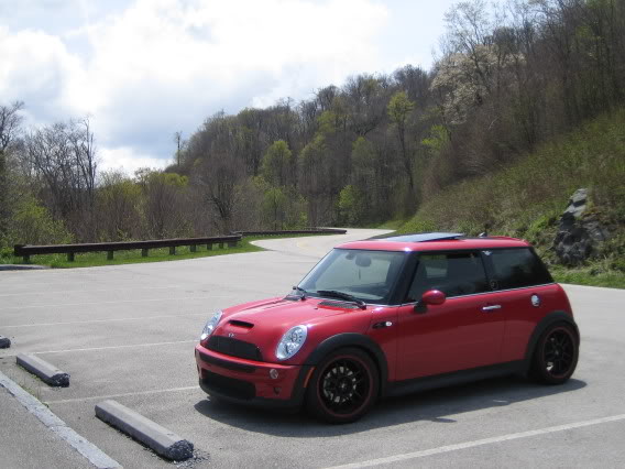

I have them on my front. I have the middle and upper and there was never a drill involved. Old one out, new one in.
