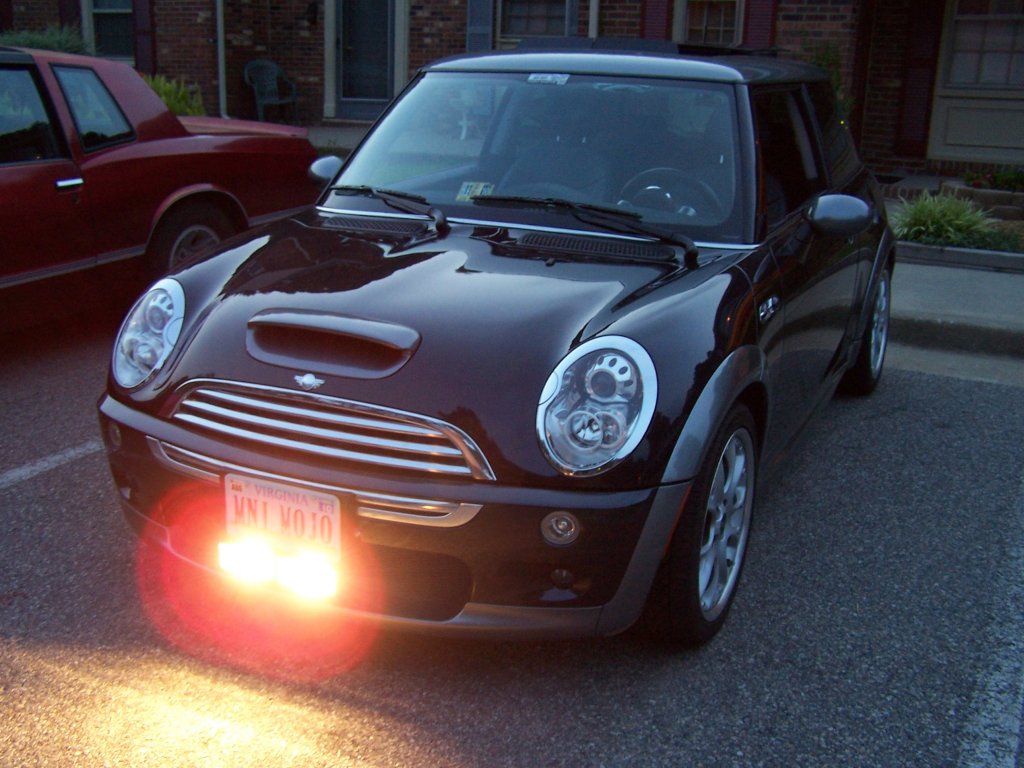

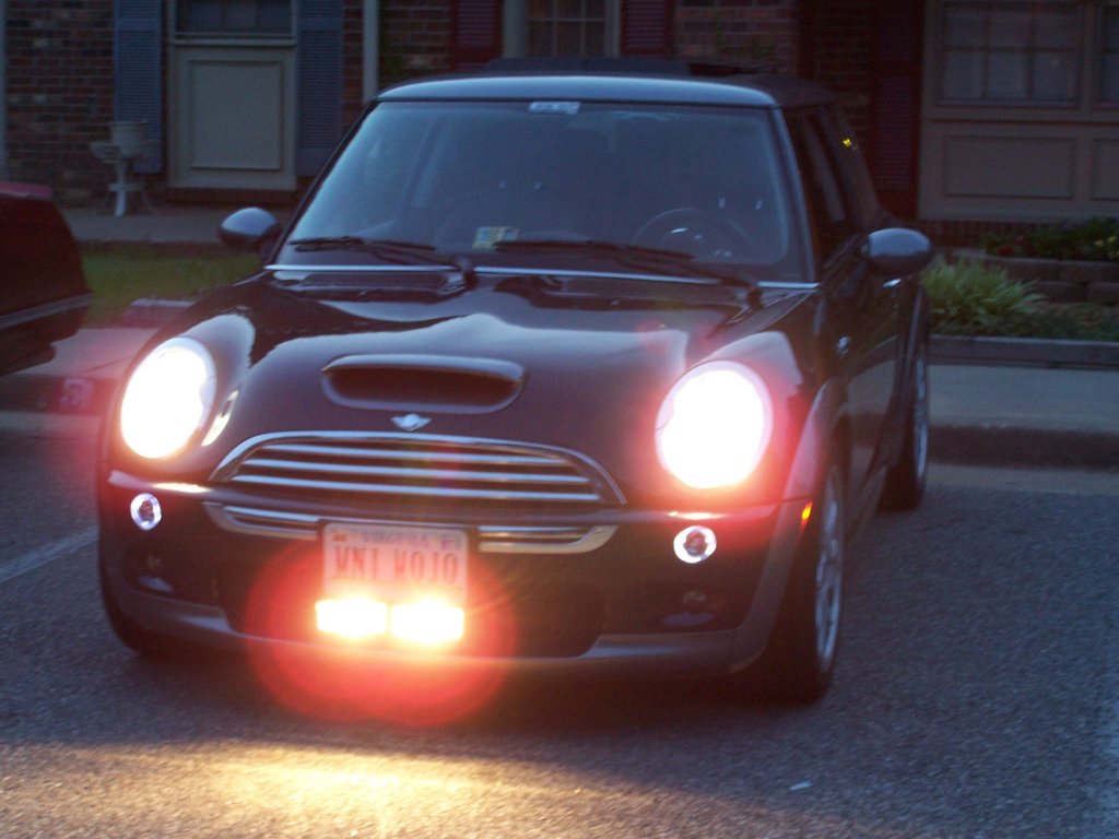

I installed these KC 26 series driving lights yesterday. Still working on the wiring. I fabricated the mounting brackets using 1" 90-degree aluminum angle bar (1/8" thick). Basically, I followed the mounting style used for the Alta driving light bar, except I have mine concealed behind the front license plate. After mounting the two brackets to the bumper, I used 3 1/2" long 5/16" diameter bolts to poke through the lower grille. I cut two small pieces of 3/8" diameter tubing to take up the slack, then bolted the cross brace to them.

Project done.

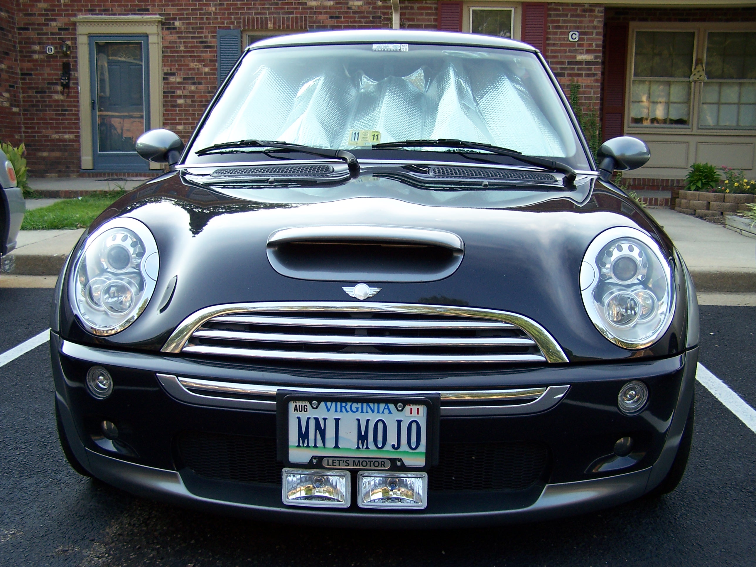

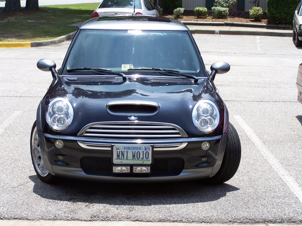

Since the KC 26 series lights were low-profile, the plastic lenses ended up melting from the excessive heat the Optilux 100W H3 bulbs put off. So, I replaced them with a set of Westin 4x6s, which have glass lenses. Just compare this photo against my previous posts. They're putting even more light downward, so I have to be careful not to adjust them too high.

They were KCS 26s (2x6"). Actually, I don't have those anymore. I put 100W bulbs in them, and the housings melted because they were plastic.
I now have Westin 09-0405 lights installed. They only come with clear lenses and are made of glass. You can still pick them up on Amazon for ~$64.
