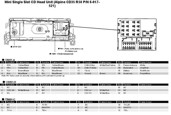

is this the same back layout for a '06 model? because the diagram says pre '03
Also does anyone have the diagram that is more clear/better quality? since its pretty much unreadable.
thanks

The original is from MINI2 and I find it readable enough ...
http://www.mini2.com/galleries/data/..._hu_pinout.jpg
I don't know of any newer drawing, and I think this one is basically still suitable for '06 MINIs.

Thanks, so how do you tell which version deck you have? A, B, or C?

Version A/B/C?
There's a big label on the bottom of the head unit with part number, serial number, build date, software revision, etc - that's probably the closest you'll get to identifying which features are present.
Features that appeared over time include H/K compatibility, AUX input compatibility, satellite radio compatibility, MP3 data file playback. The display of iPod tags (with a Dension ICElinkPlus) also requires a more recent unit.
