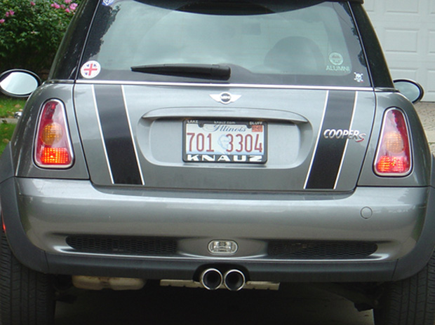

I went ahead and changed out my bulbs for LED's. I would say that they are about 90% as bright as normal. I also went ahead and took a few pictures comparing the two, stock is on the left and LED is on the right.
Attached Thumbnails LED tail light question-dsc01202.jpg   LED tail light question-dsc01204.jpg
