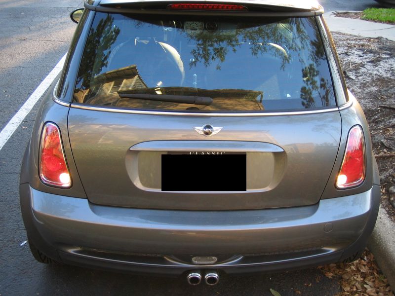

You do not need an adaptor when putting in an 05 light in an pre-05 car. Unless you want the extra reverse light. To make use of the reverse light you can do what I did Need to get amber bulbs for them though.
and yes I'm using the reverse light as my turn signals. I personally think they should've been this way from the factory. I really like amber turn signal lights but not particular fond of the amber lens in the pre-05 MINIs.

Hey no problem Remember you don't need an adapter unless you want the reverse lights to function as a reverse light! Just switch wire #1 and #3 around for both connector, and your "reverse light" is now a turn signal!
I'm all about saving $ :D
