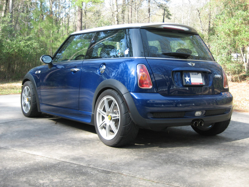

I've been working on quieting my car without paying a small fortune for it. A specific problem I've been working on is getting rid of road-roar; here in the northwest and in ski country where studded snow tires are allowed, the surface of many older roads is as coarse as frozen gravel, due to damage from the studs.
Whenever I drive on such a road, the noise from the tires on these coarse surfaces is loud enough to almost drown out the radio - like a pink noise generator with the gain up high. I call this noise road-roar.
I first bought the thickest carpet floor mats I could find - from Lloyd's Mats. I highly recommend these, and they soak up a lot of high-frequency sound, but they didn't do enough for the road-roar.
My second step was to dynamat the floor of the boot, using generic damping products from McMaster-Carr and Home Depot. This helped, but was clearly not the primary source where the noise was getting in. I next fit a couple of pieces of thick carpet in the area inside the taillights and boot cubbys, as a lot of exhaust noise gets in there, but it wasn't very effective on the road noise.
Next, a couple of layers of damping material under the rear seat, and that helped a bit too, with the sum of these things making the back seat area much quieter.
However, much of the road-roar was still getting in the car, apparently through the forward floor pan. It would appear that the floor pan in front of the seats is fairly flimsy, and not supported except at the edges, which permits a lot of resonance and sound transmission. I tried foaming the under-floor box-section beams, and this helped a little, but not as much as I had hoped.
I've been reluctant to pull the seats and carpets to dynamat the floor, as I have a bad back and don't want to pay someone to do it for me, so today I tried a different approach, which worked quite well.
The idea was simply to damp the floor pan in front of the seats, with something other than dynamat on the sheet metal. This requires some mass to keep things from vibrating and resonating. My approach was to place a couple of deadened steel plates on the factory floor-fuzz underneath my carpet mats. This damps the floor nicely, and keeps much sound from going up through the floor mats. The net is a reduction of maybe half of the road-roar - I can now proceed without turning up the stereo when I hit a section of these older noisy highways. Further, the foot-massage at traffic lights is now gone entirely, which demonstrates that low-frequency vibrations (like road-roar) are being quenched before they get inside.
To make these metal plates, I got a couple of pieces of 1/16" steel diamond-plate at the local Ace hardware, and cut them down to fit the floor on either side, roughly 16"x20" (the two sides are different shapes and sizes). I covered the flat side of the steel with a layer of generic dynamat to keep the plate from 'ringing', and sprayed the diamond side to keep the rust-demons away. I placed them on the floor, put the carpet mats on top of them, and Presto - much less road-roar now gets in, and I can hear the stereo reasonably well at 70.
The steel panels added about 18 lbs to the car, but worked better than anything else I've tried at killing the road noise, so I view this as a good tradeoff. Unlike dynamat on the floorpan, they are also instantly removable if I ever decide to do anything where weight matters, like a track day...
