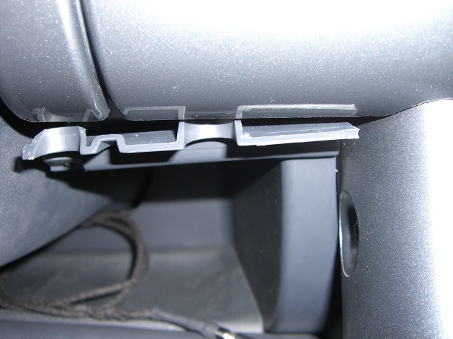

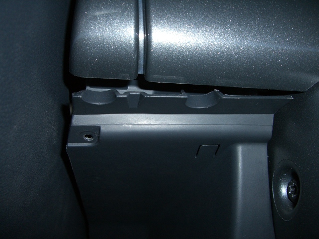

Has anyone had difficulty installing a euro parcel shelf? I have a January '05 build MCS and tried installing the shelf (part #51 16 1 188 417) but the back right side of it runs out of space against a metal part that I presume is part of the dash frame. As a result, the right side screw hole (towards the down tubes) doesn't line up and the upper right side of the tray sticks out and down a little. Here are two pictures:

I've considered tapping a new screw hole but that would still required bending the top right of the shelf to fit. Also, the plastic part that the shelf is supposed to anchor to is pretty flimsy and may break over time if under tension from a bent, jury-rigged shelf.
What to do? Is there a difference in the '05 MCSs that requires a different shelf? (I know that other NAM members have installed this shelf in '06 vehicles). I'd really appreciate any ideas from everyone or solutions if anyone has encountered the same problem. Thanks, everyone, in advance!

The right side is a bit of a PIA. I've found that you just have to sort of shove it up there. It's fairly flexible, so it moves past the resistance without issue. I always run into trouble getting the screw on the right side started - it's tough to guide it into the plastic nut. The screw goes in the left side (of the right side), nearer the steering wheel.
Definitely don't tap a new hole.

you have all the right parts, you just need to push it back a bit more. it's almost in far enough. make sure the bottom clips are clipped around the lower bar and that may help it go back far enough. some times it just needs a push up, on the part you took a photo of, to go back up under the dash parts. just give it a good push and you will be all good. hope that helps. chad

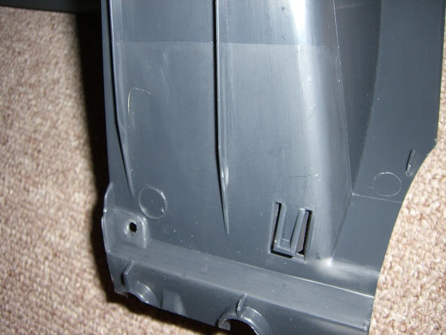

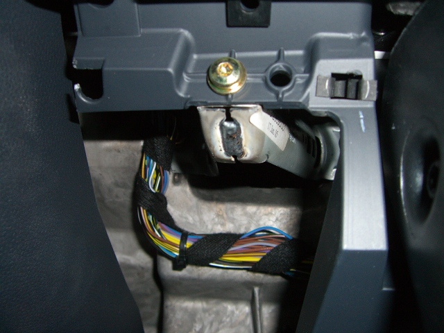

More Pictures of Problem
Wow, thanks Eric and Chad for replying so quickly! I just tried pushing it in some more as you both had suggested but it is out of room in the back. I got in the car upside down (lots of head room in the footwell!) to take more pictures. See the corner of the grey shelf abutting the diagonal bend in the metal thing? That's the stick in the mud. I made sure the bottom two clips were seated properly and that there wasn't anything in the way of the two side slots that are supposed to bear the weight of the shelf. By the way, the pictures are upside down so the top is towards the driver and the perspective is looking up from the floor.
Wierd problem, huh?

i think you missed the ledge that the parcel shelf needs to sit on on the right side. it has to go on top of the little ledge there to slide up into place, it looks like you tried to go under it.
just take it out and try again. make sure the steering column is up all the way when installing, it makes it easier.

i have been under the dash many a time upside down, but can not tell what is going on in the photo's. i see what it is hitting, but not sure why. zoom back out and take another photo maybe. also i see you have the aux kit installed. is the shelf caught on the wires? there is lots of extra wires for that unit and should be very lose. how is it mounted? maybe this is an item that is holding you back?? we are getting closer.....

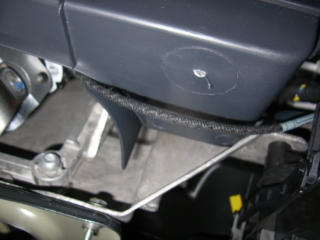

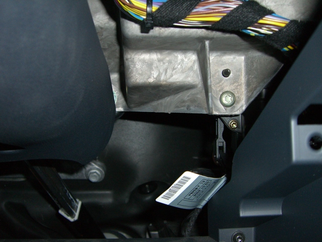

First off, I'm an idiot because I was totally wrong labelling and explaining the orientation of my own photos. I swear I know right from left but up and down just goes right out the window when you're taking pictures upside down while holding the camera right side up! So... I mistakenly posted them upside down and what they actually show is the back wall of the shelf with the top towards the bottom of the pictures (note the steering column universal joint).
The metal thing, shown in this shot
Please help... Parcel Shelf/Parcel Tray doesn't fit-cimg0135.jpg
should be above the shelf and not even in it's way. I managed to wedge the shelf past the metal thing and discovered that the real culprit was this bad boy:
Please help... Parcel Shelf/Parcel Tray doesn't fit-cimg0137.jpg
It appears to be a bracket that braces the bottom edge of the dash to the firewall. Having that extra dash support is fine by me but the monstrously large weld is causing the back of the parcel shelf to tilt upwards into the other metal piece. That weld was making contact with a spline on the shelf seen in this photo:
Please help... Parcel Shelf/Parcel Tray doesn't fit-cimg0140.jpg
You can see the white discoloration dead center where the plastic was stressed against the weld when I tried bending the upper lip to match up the screw holes. Unfortunately, my Herculean brawn (you'd find that funny if you knew me) snapped the left side of the mounting hole as can be seen in the second photo. I think it will still be fine though.
My battle plan is to shave off part of that plastic spline to clear the weld and hopefully the shelf should fit. I'll keep you all posted.
By the way, I checked the aux wire (good eye, Chad) but it wasn't getting in the way.
Thanks for everyone's help! The NAM community is great!
