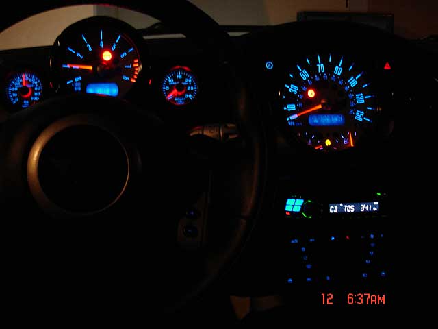

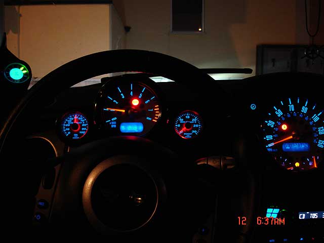

Just sharing some pics. I promised to post these a few months ago, once everything was installed. Nothing new here, its been done before. I used tips/howto from NAM and MINI2 to do mine. Also included are custom oil pressure and boost guages that match great IMO.
Attached Thumbnails Blue Dash Lights-dashctr.jpg   Blue Dash Lights-dashlft.jpg   Blue Dash Lights-gagepod.jpg

1 weekend, about 85 surface mount LEDs, solder iron, hemostats, and a lot of squinting. De-solder old LED, resolder the new.
I have a large word document w/pics -- compiled and blatantly stolen from the two guys that originally pioneered the dash color DIY.
PM an email address and I'll send it or simply do a search here and MINI2 to find the DIYs.
The guages are custom ordered from Speedhut.com No additional cost for graphics, txt or colors. They are electronic not mechanical and easily fit in the guage pod and don't interfere with the dash.

what gauge is the in the top left of this picture and how is it mounted?? The one of the outside of the steering wheel.

That's an el-cheepo "Faze" brand A/F meter... soon to be replaced by another Speedhut A/F meter. Speedhut only just released an A/F meter.
Its mounted on the A pillar with a universal pillar pod. I used a heatgun to remold it to more accurately fit the A pillar. The pod is the same dark grey as the dash. It doesn't clash too bad with the off-white A-pillar.
