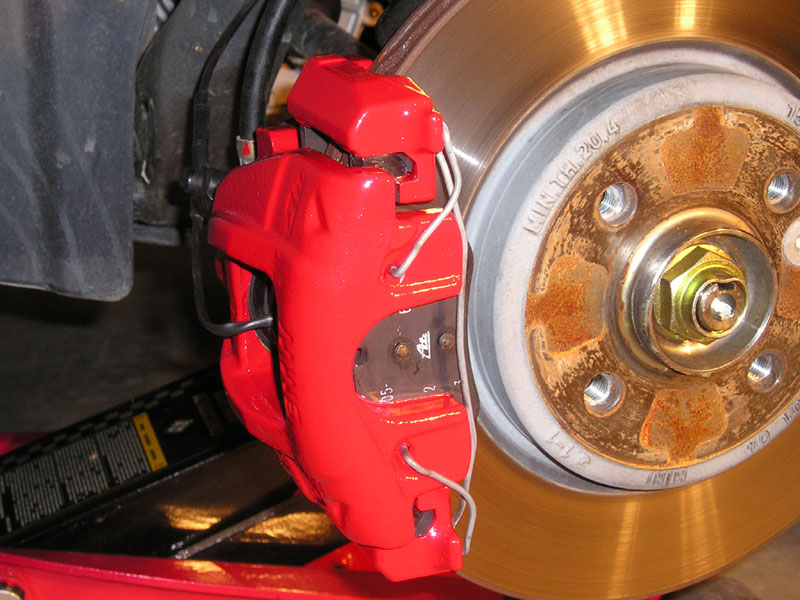

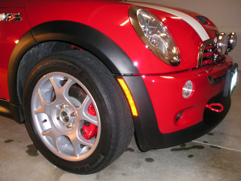

I finally did mine and thought I would post a few photos. I used the G2 kit and it went on really well. It will look better with my new white Ro-Ja LT5s. I'm still waiting on tires.

Nice job MINI Monkey! They look almost too perfect - did you totally remove them to paint, or did you paint them in-place? I've been wanting to do this to both of our MINIs.

I've painted calipers on two different cars. Never masked anything, never disassembled, just took my time, and they turned out great.

Thanks for the compliments.
I left the calipers on and just masked them off well. I talked with the lady at G2 and she said it is OK to mix half the paint and half the activator. That would work great for doing two cars. You have between 4 and 6 hours to work with the paint. Afterwards the car has to sit for 24 hours before being driven. I had a little under half a can left that just went to waste. Thanks again Dominicminicoopers for all the tips.
