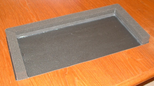

Got my unpainted glass scoop this morning via FedEx. It looks excellent, and about twice the intake size vs. the stock letter slot.
Here's a pic of the airdam I made up to replace the stock black piece and foam.
The black sheet is generic "dynamat", the foam is 1-1/4 x 1-1/4"" foam from the hardware store, and the clear stuff visible on the foam is silicone rubber to help block air flow through the foam. The gap at the bottom edge of the scoop should be blocked off by my diverter mod.
Yippee! Now to get the scoop painted LY...

Old Rick--why did you install a new seal? Is the new intake scoop inconsistent with the old stock seal? My scoop should arrive real soon and I will be running the stock IC. Back in early Jan when I ordered it, Peter assured me it was a 10minute swap for the OEM scoop.

I haven't tried to fit it, but I guess you could use the stock black plastic piece.
However, it takes up about 1/4" of the air plenum space above the IC, and does nothing useful besides holding the foam piece.
I figured I might as well match the height of the intake hole if possible, and this is a convenient place to damp the sheet metal hood somewhat.
