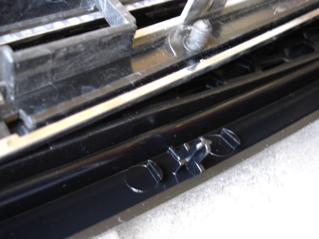

Hey I was just asking if anyone has ever installed the bonnet aero grill on their car. Did your aero grill tab have threads? Because the bonnet aero grills I have seem to only have these little slots that don't have any thread on them so I can't put a nut on it.
The top one is the stock grill tab and you can see that it has threads for a nut while the bottom is the aero grill that doesn't have threads. I guess I can glue it on but from reading reviews etc people seem to have screwed their aero grills onto the car.

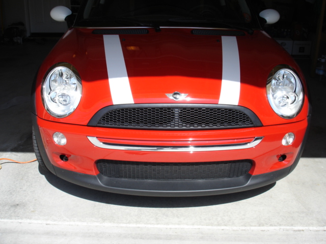

Ended up glueing it heres a pic and I'll install the lower grill later this weekend.

danbanger --
The posts on the Aero Bonnet Grille accept the nuts from the old grille. The nuts are self threading so they will cut threads into the X-shaped posts. However, they still don't seem as secure as the original solid posts. Just put avery small dab of epoxy on the top of each nut after tightening it down.
I've done both the bonnet and upper aero grilles and did a write up that you can find HERE. There are also some pictures. Note that the bonnet grille is a walk in the park compared to the upper grille!
