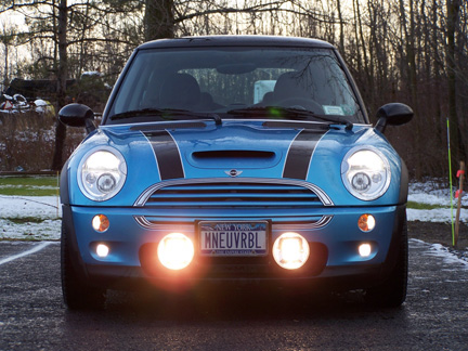

Okay seriously though, I have the Alta Rally Style Light bar, http://www.altaminiperformance.com/p...r/lightbar.htm
The IPF lights have kinda a dual-lens design. They call it a fog/driving lamp. The lens has a square section inside that has vertical lines, to diffuse the beam like a fog lamp, but the remaining outer circle is a smooth parabola, meant to send out a long high-beam pattern. It gives you both fog and highbeam light. The picture below shows this a little bit, sorry not a head-on shot...
The beam is both spread out, and at the same time, very focused, the best of both worlds. Bear in mind, I only have 2 of the 4 lights that normally come with the Alta kit, because of New York State's front license plate requirement... Imagine if I had all four hooked up! My night vision is spectacular. I spotted 4 deer this winter much sooner than I could've before, of that I have no doubt.

To answer Doomsdaybob
The alta light bar is pre-drilled for four of the 6" IPF lights. My lights pretty much butt right up to the sides of the license plate frame.
Now, if you don't need to have the license plate in the front, you could certainly mount 3 of the IPF lights. There's plenty of space to do so, but you'd just have to drill a hole in the very center of the bar that holds the lights... I attached a front view of my car for you... click on the thumbnail to enlarge...
