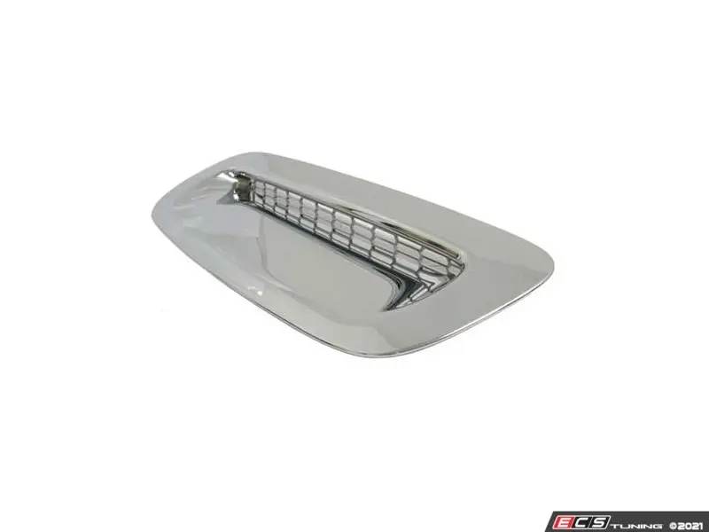

The only think I see chrome on ECS is an adhesive attached cover. I don't think that's the right solution for what I've got?

Yep,
Thats the only one we have. Its not a flush fit with the hood. It stick on top. Yours is a complete unit and that style is nla in chrome. It was popular back in the day, but not so much now. People do the black or painted body color (which come primed and linked above).
That chrome one from ebay its the aftermarket bumped design. Not OEM.
The heat cooks those chrome scoops after a while, their was a factory shield that helps this.
