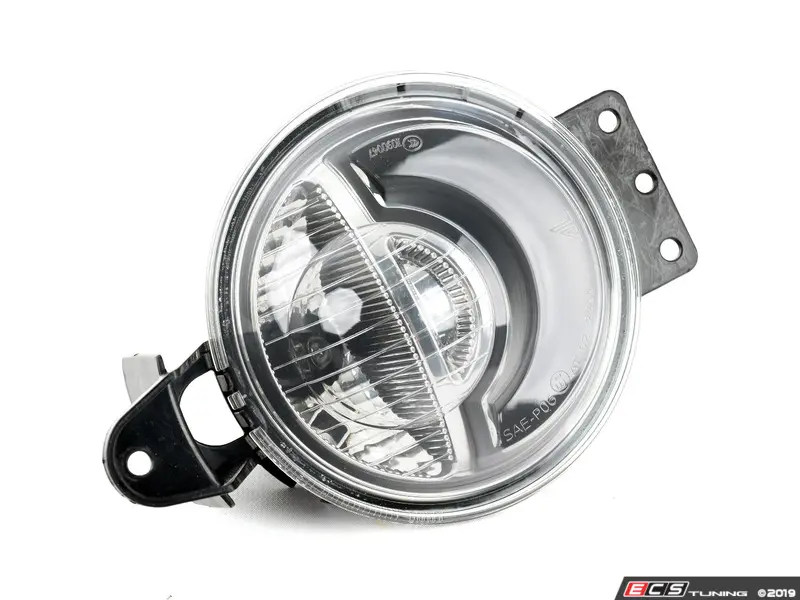

The factory wiring might not be there for the fog lights, but you could easily run some power wires to get them illuminated. The parking only housings are one piece integral with the brackets. The fog light housings are separate from the bracket. If you have the parking light only housings, just need to get some brackets for the fog lights. Then, just need to figure out the wiring.

Anyone know the part number for the brackets?
From post #2 above:
https://www.realoem.com/bmw/enUS/sho...diagId=63_1246
Item #6 - 63129807305
https://www.ecstuning.com/b-genuine-...h/63129807305/
