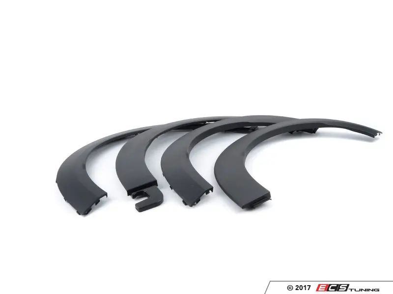

Hello and happy weekend all,
A couple of weeks ago I installed the genuine MINI Euro JCW wheel arches. After receiving a few questions from local MINI owners I thought I’d write a post about them
: Purchased from SMPS2012
- Each wheel arch is shipped in its own BMW/MINI envelope with the clips pre-installed
https://www.smps2012.com/product-pag...rches-x4-piece
: Removal is straightforward and the only tool required is a trim removal tool if a clip remains in a body panel
: Installation time is about 5-10 minutes per arch
- It took a little longer because I cleaned and protected the paint under each arch before installation

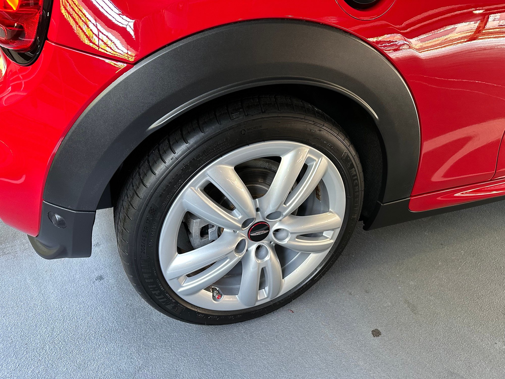

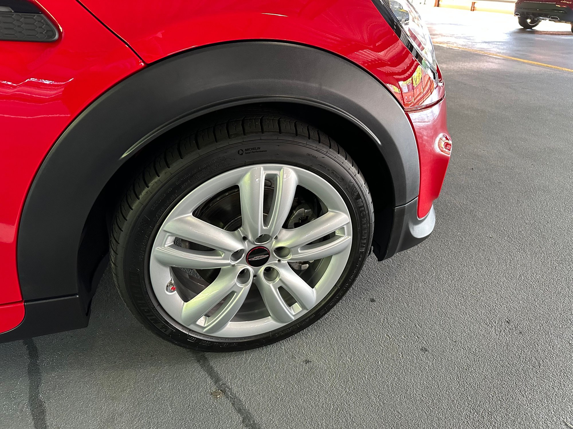

: Existing side marker wiring
- I cut the fingers off of a powder free nitrile glove, placed the side marker connectors in each finger and zip tied each one (to keep clean from debris and liquid)
- Front connectors were ran into the engine bay
- Rear connectors were ran further upwards behind the wheel liners
*fun fact: MINI OEM zip ties were used
https://www.ecstuning.com/b-genuine-...131367599~oem/

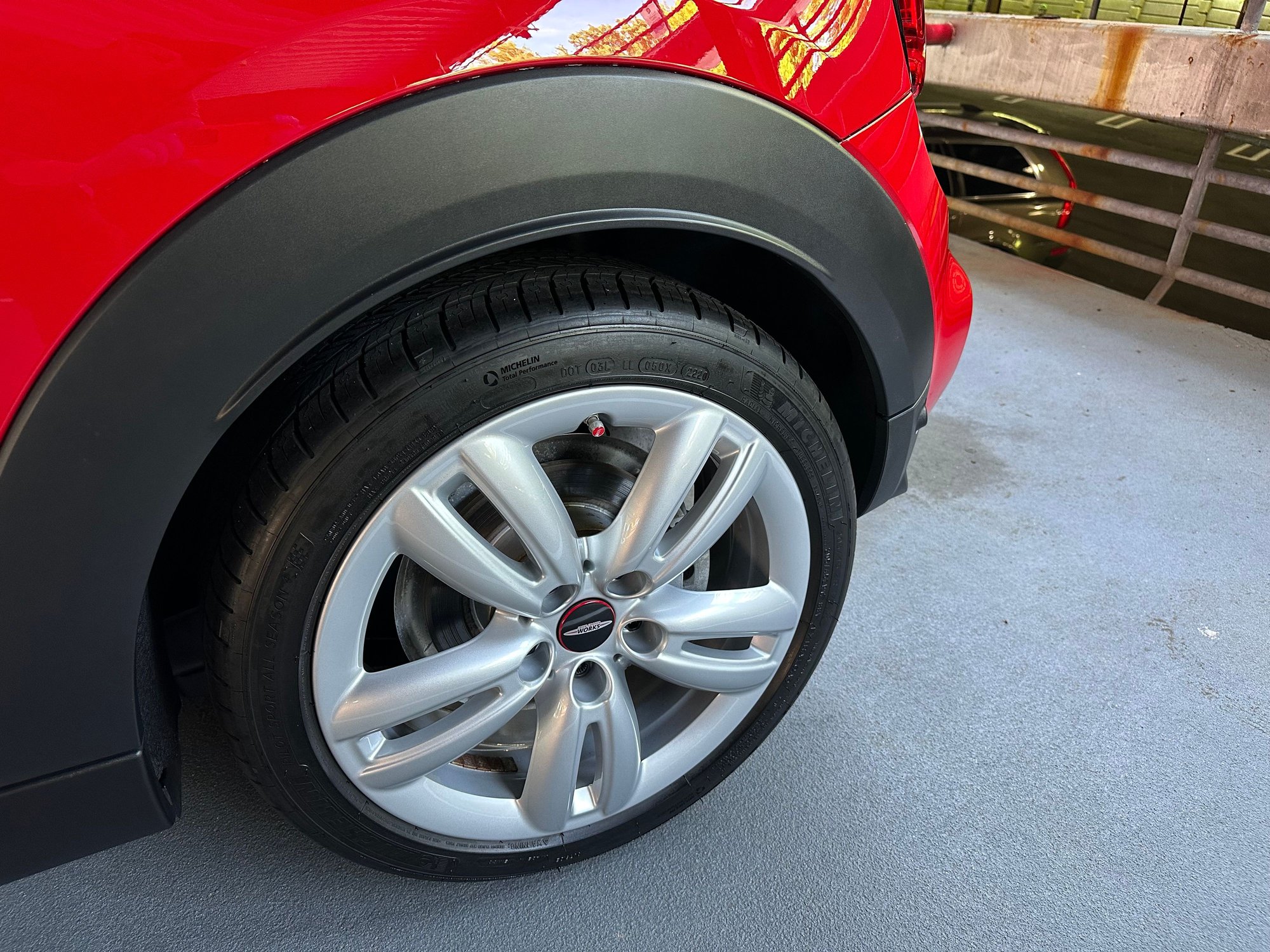

: Protection
- AMMO Frame Pro Trim Coat was applied to keep them protected from sun damage/fading
https://ammonyc.com/collections/exte...-pro-trim-coat

I love these arches, the MINI looks so much better/cleaner without the markers

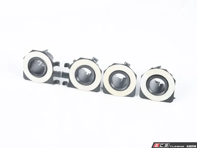

hello i have a 2018 f56 . and im looking for euro fender arches and i have PDC . on your site i see kits but i dont see kits for ones with PDC
Old Nov 21, 2025 | 10:39 AM
Posts: 36,762
Likes: 2,551
Hello,
We never brought them in for cars with PDC as they were not as popular. They would also take a while to get in by boat and other euro parts we order.
https://www.ecstuning.com/b-genuine-...an-mini-parts/
MINI also just NLA'd some of the factory front factory PDC ones for US cars, so guess what's next for euro versions.
What you have to do if cut and mount the sensors from the old archers into the NON PDC ones.
As you can see BMW have been removing the pre cut ones across the board and you have to cut and mount.
BMW guys drilling bumpers. https://f30.bimmerpost.com/forums/sh....php?t=1073417
https://www.ecstuning.com/Search/SiteSearch/PDC_mount/
Their is a factory tool but it was $$$$ if i can dig and find it. But it does not make sense to buy.
Here is the universal tool , you have to match up to the factory part and then remove the section of the mount from the old part to the new one and use either thin double sided 3m tape or glue it.
DIY with like tool.
Tape: https://www.ecstuning.com/b-3m-parts...15-ft/3616~3m/
https://www.ecstuning.com/b-baum-too.../b2334053~btu/
B2334053 Parking Sensor Installer Set
