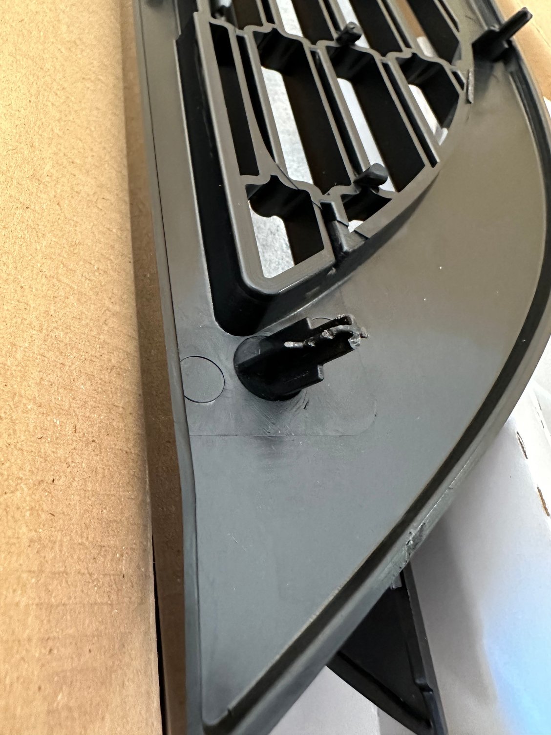

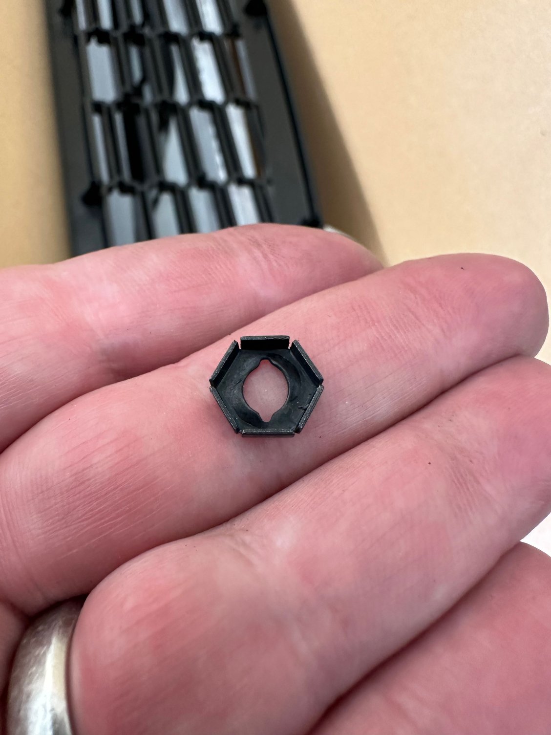

Just picked up an aero grill and unable to get the flange nut to install on the post. Any suggestions or tool I should use?

They can be hateful. Just press and get them started on to the plastic stem, They should self-thread with continued pressure while you wrench.

+1 yes you thread them on slowly and then use a small socket or wrench

Was able to get them installed. Went slow and carefully able to thread them on. The ones towards the to of the bonnet were the most time consuming.
