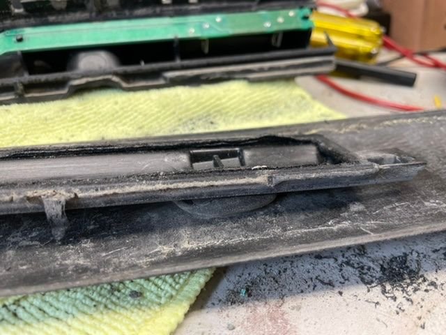

I started by trying to file the glue away with fishing line. This only works for the end though - once you’re into the central glue spots, the fishing line will catch onto the plastic protrusions and either do nothing or rip. So your best bet is to Dremel the plastic frame so you can rip the central assembly out and then more comfortably file away at the glue spots.
You can kind of see how thick the glue is here.
