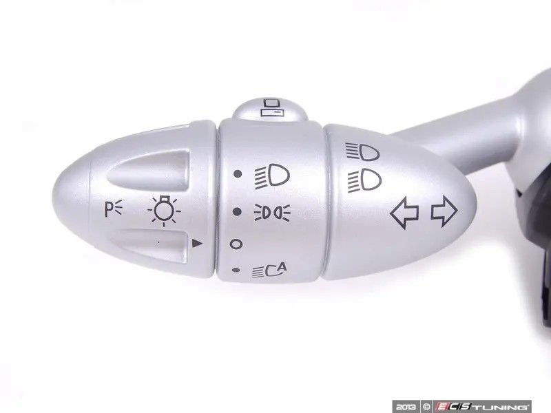

I have this
can i use this on a pre facelift?
only two wires are inverted, i want this because it has the automatic lights

You might but you will almost certainly need to reprogram one of the computers in the car to tell it that it now has the stalk for auto lights and the computer (the little button on the top there). I also do not know if the auto headlights will work just by adding a different stalk as I think that there is light sensor somewhere in the car to tell it when to turn on the lights and when to turn them off.
Email ECS, they probably will know.

Thanks for the answer, I've the rain sensor and according to the wiring diagram, only two wires are are swapped, technically it should work

Yep , one is for the OBC/auto lights and one is for the stock, no OBC upgrade. It will have to be flashed at the dealer to have OBC function turned on and if you want auto lights: https://www.northamericanmotoring.co...ience-pkg.html
