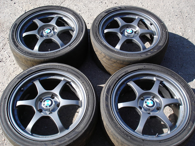

To actually answer your questions.
1) For a 17x8 wheel I think the ideal tire for performance driving is the widest one you can reasonably fit on there. In my opinion that would be a 245/40. You can see what that would look like here: https://lh3.ggpht.com/_Rp88yFWVAvs/S...640/SSRs_1.jpg
However, as both I and thebmwnut have said, a 245/40 tire will rub on a lowered car with unmodified fenders. And it will rub a lot. I know someone driving in Gridlife that needed to cut the fenders and run wider RSi C6 flares to fit a 245/40 tire on a 17x8 wheel. I'm not sure of his offset though.
As I stated earlier I'm running a 225/45, I'm lowered about 2" and have 1-1.5 degrees of camber all around. It's really the widest wheel and tire combo you can fit reasonably under the stock fenders without compromise. I could easily raise the front of my car about half an inch and have zero rubbing, but my coils are frozen in place and I'm just too lazy to deal with it at this point. If you want to see my car it's here: https://www.fitmentindustries.com/wh...te37-bc-racing
This website is also useful for seeing other cars with different wheel and tire setups and owners can also comment on how much rubbing they have if at all.
2) I think for the kinds of wheels you're looking for, Rotiform and Fifteen52 are the most popular brands out there. But both are going to be pretty heavy cast wheels with thick spokes. I think you really need to consider here whether you want the look or the performance. If you want the look, those two brands right there have plenty of cool styles close to what you like that don't break the bank. If you want the performance, there are a lot of other brands that offer lighter wheels in different styles around the same price.

Sorry I misunderstood then. You asked about the best tires for 17x8 if you were doing aggressive driving. At least in my mind that's a bit counter intuitive, because again the best tires won't really fit. However if you're absolutely insisting on running a 17x8 wheel I can tell you that you'll probably be able to fit a 215/45 size tire and have a bit of wiggle room on the offset to not hit the wheel on the strut. A 225/45 might fit, but as I've said the fitment is going to be tighter and depending on the specific wheel and tire combo you'll probably need somewhere in the range of a 42-37mm offset, which I don't think will work with a 17x8 wheel as it doesn't allow clearance between the wheel and strut.
I mentioned that Fifteen52 makes look-alike center lock wheels, the Chicane and the Podium specifically. Both are available in 17x7.5 as well, which you could run with a 225/45 tire as I do. And if weight is still a concern, these will still be on the heavy side but they will definitely be lighter than the Rotiforms.
