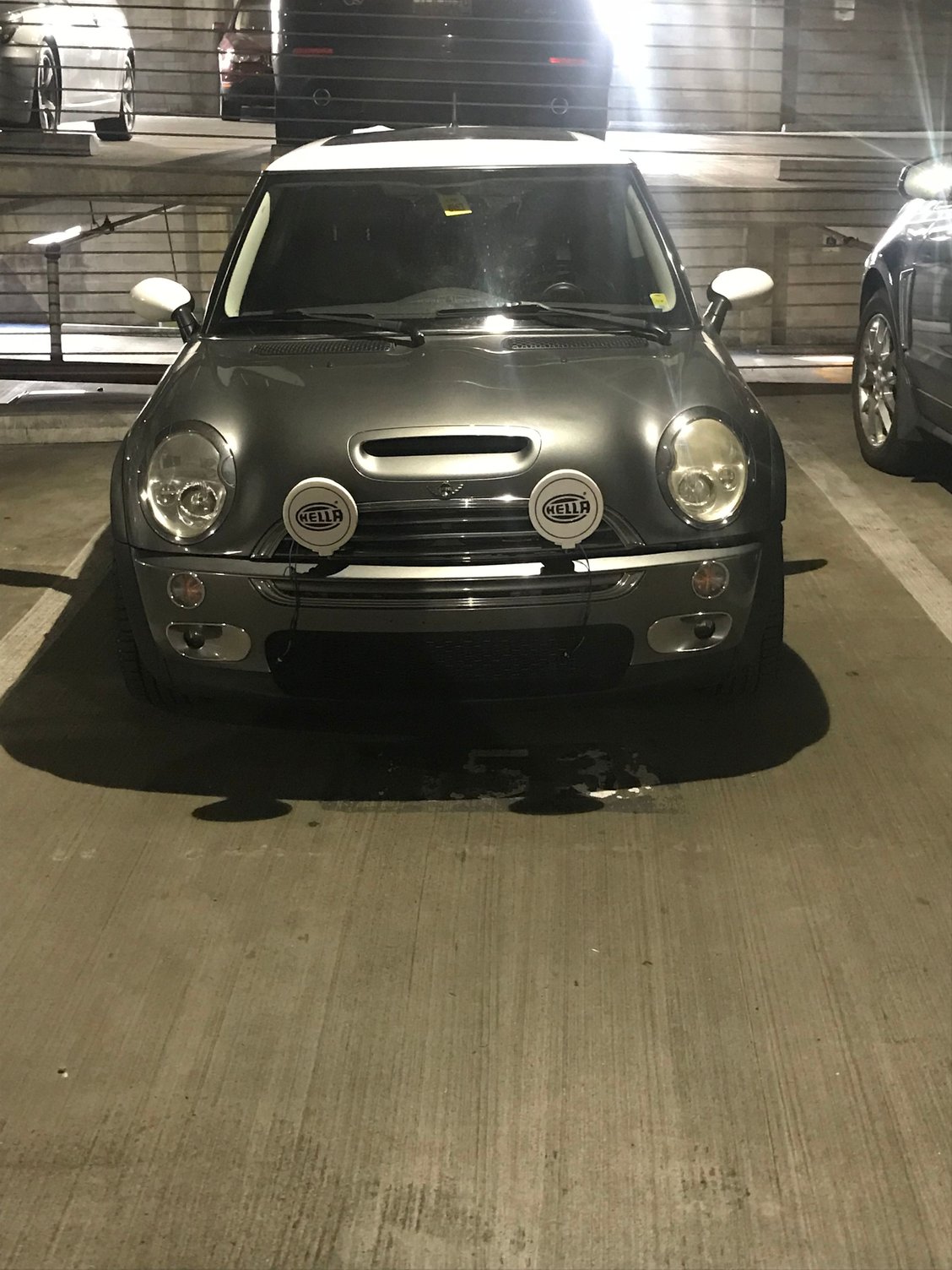

I'm adding driving lights to my car and I'm down to drilling the holes for the brackets and screwing the lights on. Anyone have any advice on paint or other treatments to prevent leaving exposed metal that can rust?
