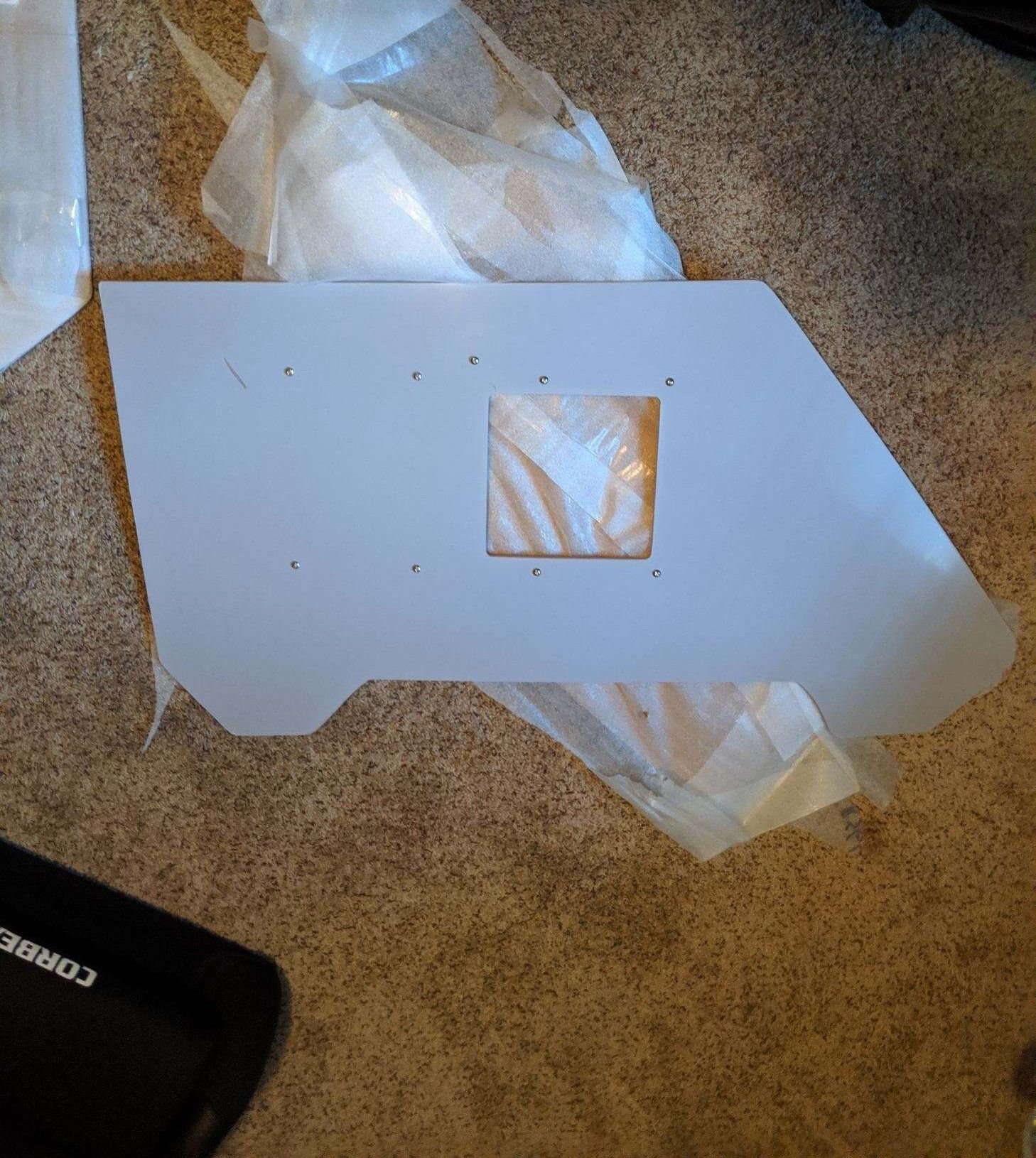

yeah I tried to install them as clean as I could
I found a couple posts on Instagram
an a couple forms from overseas and most of those guys
just riveted the window to the door
witch I wasn't a big fan of
so what I did
it's pulled the stock window regulator all apart
and used the stock slides an rails
to install the windows
I drilled holes in the sliders where the window sit in and drilled another
set of holes on the rail and put a bolt through
and tighten it all down
that way the sliders don't move up an down on the rail.
then basically just installed the windows as if they were normal
glass windows
The struts they send you
are actually surprising function great
the window doesn't rattle at all it's actually pretty solid
I got a set of lohen lightweight door cards
that I'll be putting in next.
once I get it I'll put together I'll snap more photos and post
