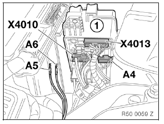

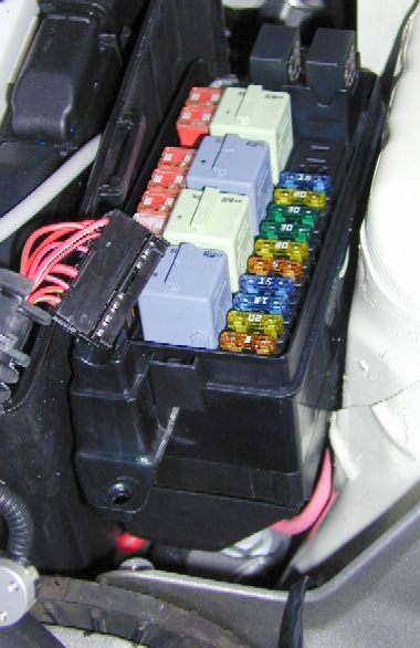

Now it's my turn to need some help. I had installed the fog lights but the rest of the harness has been coiled under my hood for the past few weeks until I could get back to it. I had some time today and started on the next step, which is to hook up the harness to the fuse box in the engine compartment. Well, I immediately got stuck as I couldn't figure out how to open the underside of the fuse box.
The drawing in the instructions shows the underside of the fuse box exposed, where I will have to access the connectors:
Here is my fuse box unbolted from its mount and tilted up slightly (the top cover is removed):
There is a plastic cover (outlined in yellow) over the bottom of the fuse box, where the connectors are. The bottom is completely closed except for an opening at the far end where cables enter. I'm sure there must be tabs or hooks to release the bottom cover, but I spent the better part of an hour looking for how it comes off. Not wanting to force or break anything, I simply put everything back for now. Does anyone know how to take this cover off?
Attached Thumbnails Oem Fog Lights-diagram.gif   Oem Fog Lights-fusebox_1.jpg   Oem Fog Lights-fusebox_2.jpg

RealOEM has this exploded view of the engine compartment fuse box:
http://www.realoem.com/bmw/showparts...39&hg=61&fg=20
At least I can see how it's put together, and I'll make another try at pulling off the bottom cover later this week. This is rather embarrassing for me because it seems like it should be so simple.
