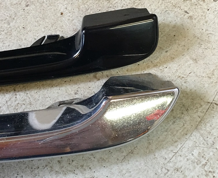

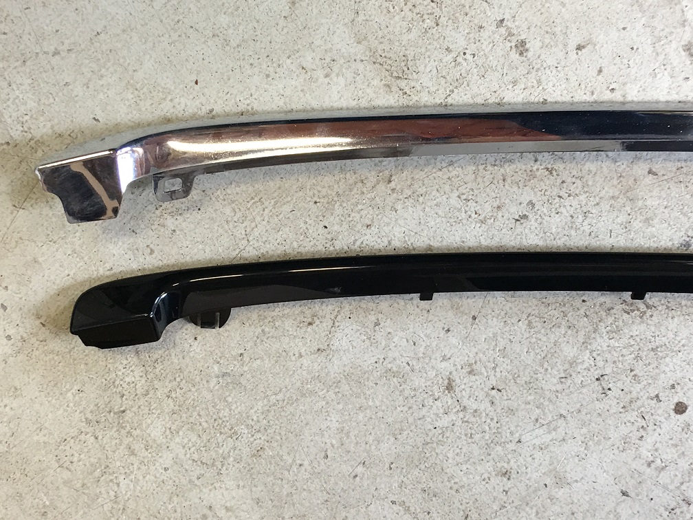

Hello from Holland.
I have a Cooper R56 05-2010 N18 engine, blackmetallic car orignally delivered in Holland, everything OEM.
Have as option 7AR Aerodynamic Package (not the JCW Aero Package). That means everything is black painted so not the "black plastic" around the wheels. Original the car has chrome around the grille.
Parts numbers:
Hood / top part chrome 51132751040, Bumper / lower part 51117195418.
I ordered at my German dealer (because I am living close to the German border) black grille trims, and got these parts.
Hood / top part black 51130417135 which fits perfectly, Bumper / lower part black 51130442011 which doesn't fit at all.
Probably it will fit for the JCW bumper but not at my car. See pics, it will make it more clear.
Can you help me at the right parts number?
Reason to ask you is that the 7AR Aerodynamic Package is more USA and rare in Europe. Thx in advance (driving now with a missing part)

On RealOEM I can't find a black painted trim cover for the lower grill that fits the 7AR aerokit. http://www.realoem.com/bmw/enUS/show...diagId=51_6589 Part 3 is the only one, only chrome
