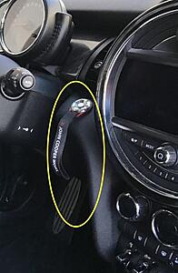

Can someone ID the p/n for the panel? I would like to have a spare on hand.

51459384650
http://www.realoem.com/bmw/enUS/show...diagId=51_9610
