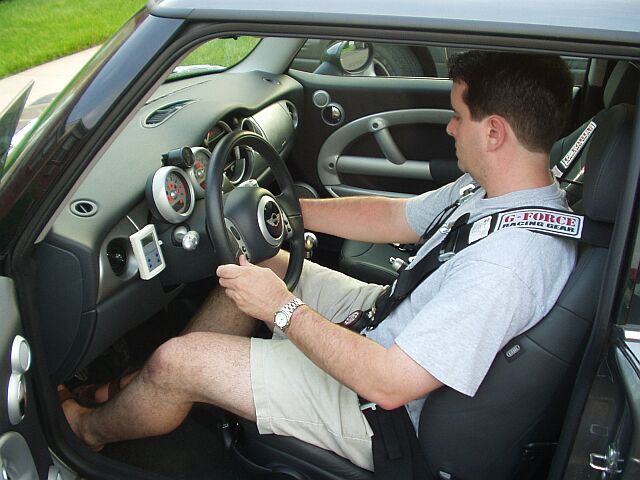

Agreed, 5-pt makes SOOO much more sense:

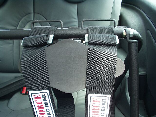

Hey andy, do you have a harness bar in the back? I don't remember seeing a cage last time I passed you on the turnpike,
Old Aug 30, 2004 | 06:41 AM
andy@ross-tech.com's Avatar
andy@ross-tech.com
Joined: Oct 2002
Posts: 3,652
From: Lansdale, PA
Yep:
Luckily, it is easily removable with just 4 bolts, so I don't have it in most of the time.

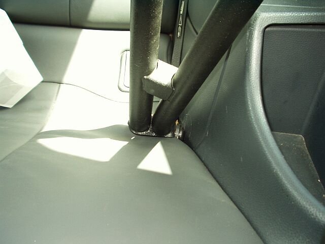

does it bolt in through stock holes?
Old Aug 31, 2004 | 06:58 AM
andy@ross-tech.com
Joined: Oct 2002
Posts: 3,652

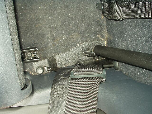

From: Lansdale, PA
If you are talking about the harness bar, then yes. The attachment points are the factory locations for the outboard rear lap belt and the outboard front lap belt.
It's pretty slick: you install a bracket to each rear lap belt mount. The bracket can be left in all the time and the rear seat is still useable:
The front uses a bracket that is held in place by the factory front lap belt mount:
Even though the harness can be in place with the rear seat in, obviously passengers would not be welcome back there.
