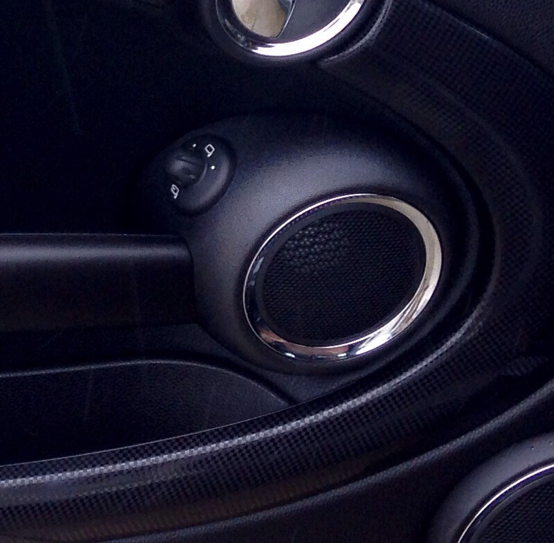

So my trim is arriving today. Or at least the stuff that's not on back order. Does anybody know how to remove this speaker cover?
I can find info on removing the panels, but not these. Even though one has the mirror control, I figure the have to be similar.

Disclaimer: I haven't tried this myself. My Bentley manual says the outside trim ring is removed as follows: 1. Remove the outside mirror switch by levering it off with a plastic prying tool. 2. Using the same prying tool, lever the speaker trim off plastic catches and detach from door panel. The 5 plastic catches are located at 12 o'clock, 2 o'clock, 4 o'clock, 8 o'clock, and 10 o'clock. When reinstalling, make sure the plastic catches and foam gasket are undamaged. Good luck.

Success! Thank you to everybody who provided help.
